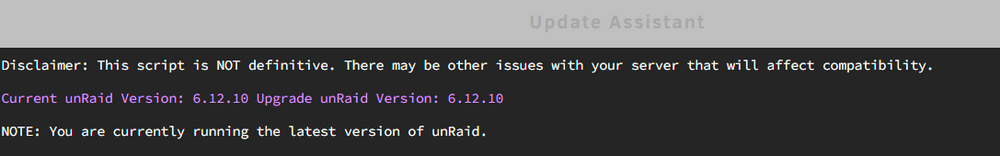

For whatever reason, the 6.12.11 update would not show up for me so I had to use the .plg link to manually update (https://stable.dl.unraid.net/unRAIDServer.plg).
