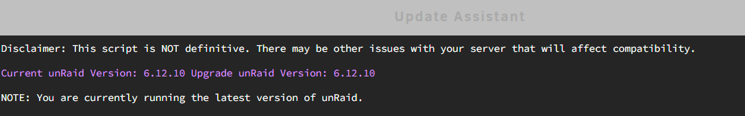

Noticed on two running instances:
Instance 01 - does not populate 6.12.11 update available in banner + update assistant does not detect 6.12.11 new version. <6.12.10 detected as latest>
Instance 02 - does populate 6.12.11 update available in banner + update assistant does not detect 6.12.11 new version. <6.12.10 detected as latest>

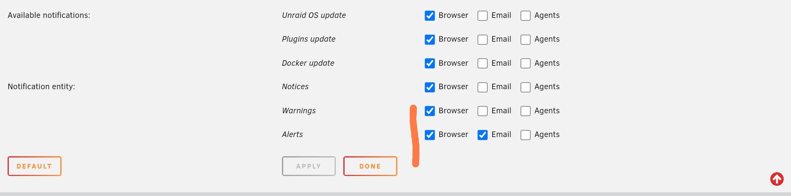

Check Settings > Notification Settings > Unraid OS update notification: _____
Update went smooth on the 17th. No issues occured since. Great!
You're talking about these?
Screenshot_2024-07-24-23-03-00-130_com.android.chrome-edit.thumb.jpg.4bc62fcea5e30d909261ed1a95e5a8f9.jpg
Still no update banner in my browser. First time in many years as I wrote.
Right above that, how often is it set to check for updates? I had the same issue until I checked and saw it was not checking
image.thumb.png.e13708d8daced13a9d6e19db2c7c0763.pngimage.thumb.png.e13708d8daced13a9d6e19db2c7c0763.pngimage.thumb.png.e13708d8daced13a9d6e19db2c7c0763.png
Ooops, that it was. Thanks a lot. I switched that to once a month to avoid repeating notifications. Wish I could set it to notify once.

Any word on update assistant seeking the latest version?
I understand manual intervention will work successfully... was curious if the dev-team was aware?
Thank you.
Update assistant isn't part of unraid, it's third-party (provided by the Fix Common problems plugin). Maybe post in that plugin's support thread.
