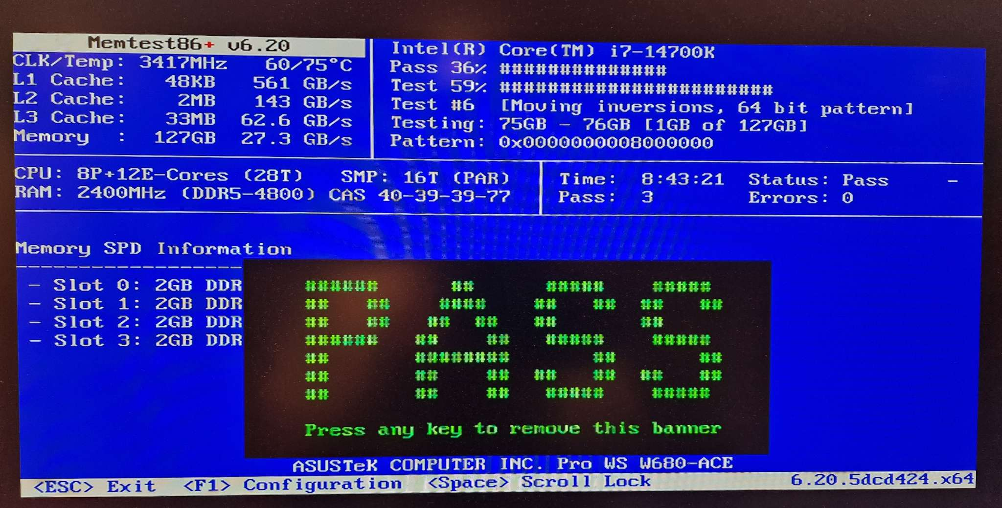

After upgrading to UnRAID 7.0.1 on both my servers I'm struggling that the WebUI becomes unresponsive on one of them (with 14700k/w680 motherboard). It just dies completely. Trying to run "htop" from SSH also crashes while the terminal/shares/docker seems to continue to work. The only thing that I can find in the logs is this being logged multiple times over:
[ 2663.825421] python3[537547]: segfault at 6 ip 0000152dc136e9f1 sp 0000152db6db2d20 error 6 in libpython3.11.so.1.0[152dc126c000+1d4000] likely on CPU 12 (core 24, socket 0)
[ 2663.825429] Code: 7e 3f 49 8b 7e 18 48 85 ff 74 0a 48 83 2f 01 0f 84 30 03 00 00 48 83 7b 18 04 7e 25 b8 04 00 00 00 49 8b 3c c6 48 85 ff 74 0a <48> 83 2f 01 0f 84 1d 03 00 00 48 83 c0 01 48 3b 43 18 7c e3 0f 1f
Are you familiar with this issue? I have two UnRAID servers on 7.0.1 and they use the exactly same plugins/versions (just the hardware is different), but only one of them seems to struggle with this. Is this plugin somehow incompatible with my HW or any idea what may be happening here? I have no Python scripts in "user scripts". I only use Python in order to manage my docker containers (using docker-compose without pip-dependencies) so that's why I would prefer to have it outside of docker if possible. :)

I'd recommend running an extensive RAM test since a segmentation fault occurs when a program tries to access an invalid memory address. The issue could be with Python mistakenly thinking the address is valid, or with faulty RAM corrupting previously valid memory. Since there aren’t widespread reports of this issue, my first guess would be a problem with your RAM.
Unless you are running some programs in Python that are directly working on the memory (C/C++ bindings come to mind...)?
Nope, it's only a quite simple Python tool to mange the docker containers, so nothing that would work on the memory directly causing issues like this. I use ECC memory and did take a memory test (maybe not extensive enough?)
Edited by NeoID
