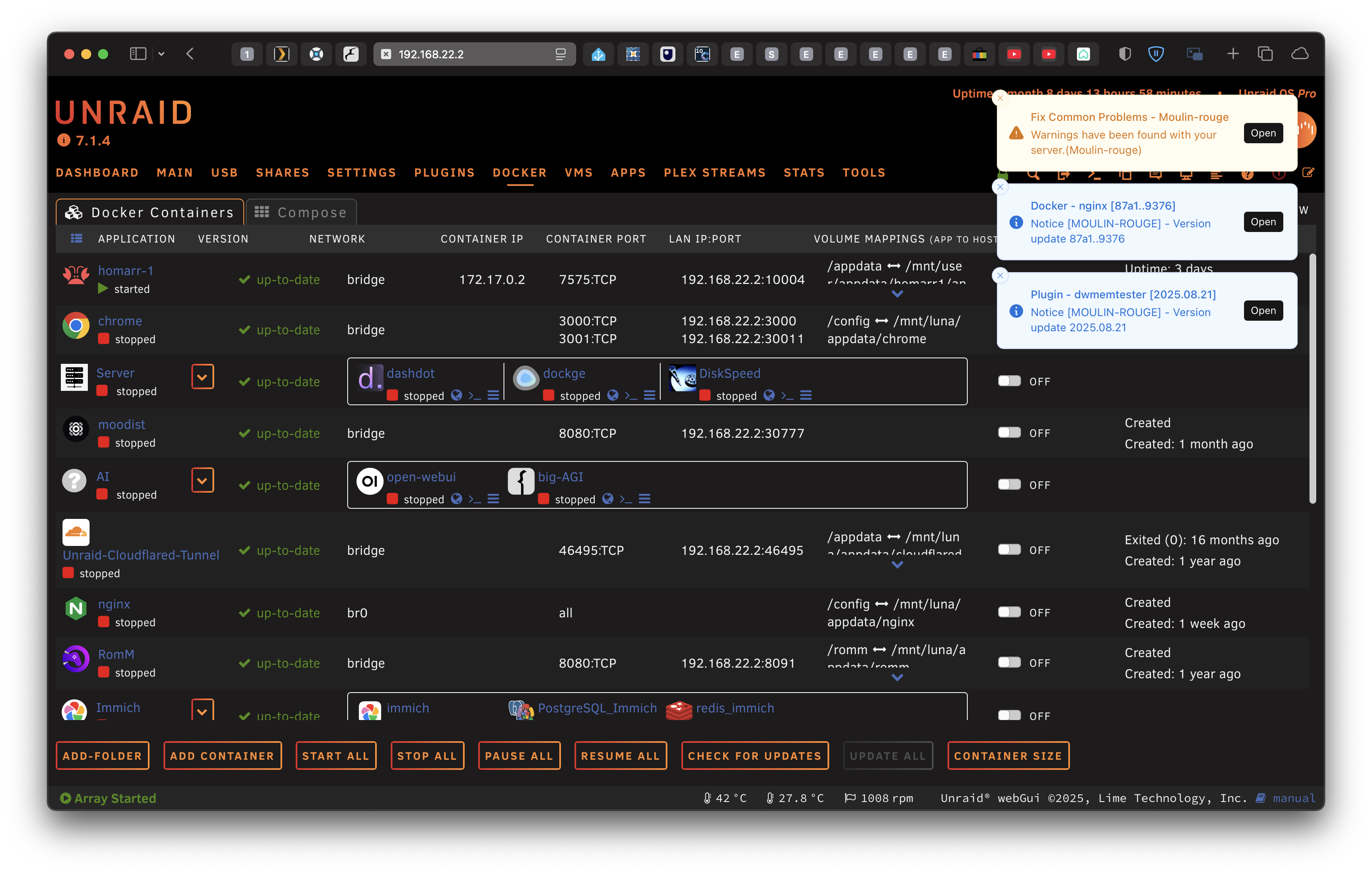

Please can we sort out colours for Dark Mode in the connect plugin? 😎
