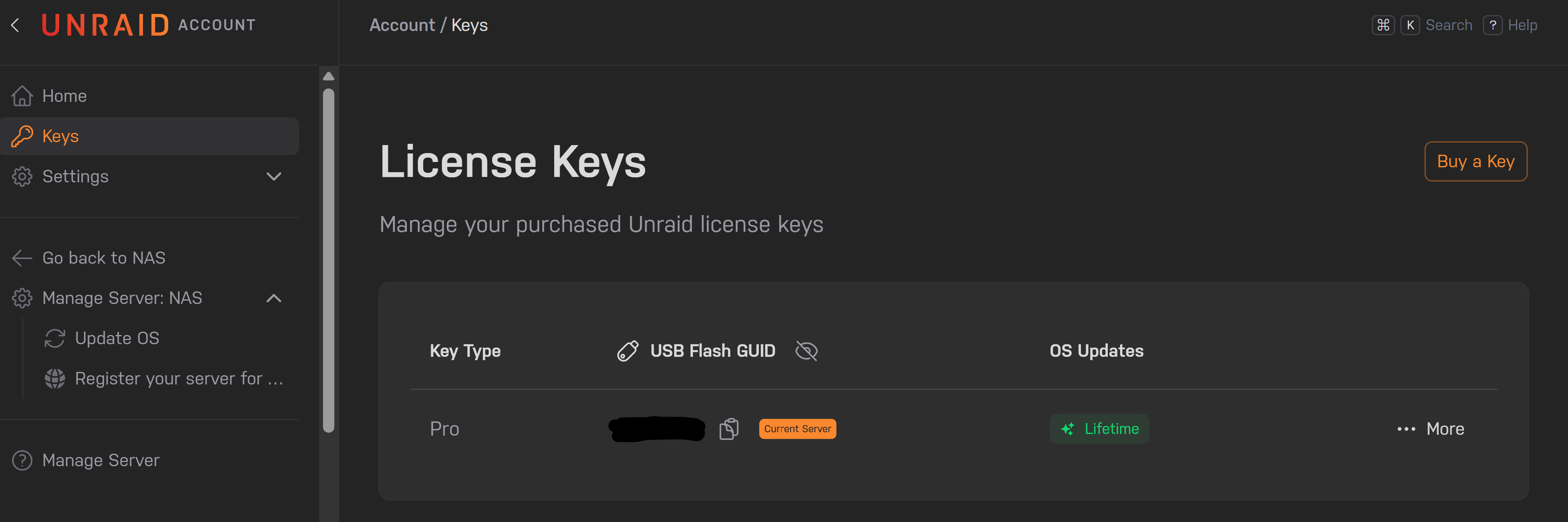

August 31, 2025Aug 31 Community Expert It was indeed an infrastructure issue on our end . The delay in the solution working was due to our script needing to backfill every sign in into our auth system. If you continue to have issues signing in, try going to the keys page in the account app, then back to the register server page. This will force a token refresh and validate the sign in.

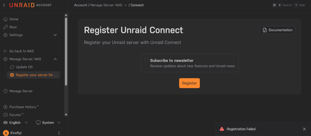

September 2, 2025Sep 2 On 8/30/2025 at 10:45 PM, elibosley said:It was indeed an infrastructure issue on our end . The delay in the solution working was due to our script needing to backfill every sign in into our auth system. If you continue to have issues signing in, try going to the keys page in the account app, then back to the register server page. This will force a token refresh and validate the sign in.I went to Keys and can see my key. I then went to Register and after clicking Register I still get a small pop-up that says Registration Failed.

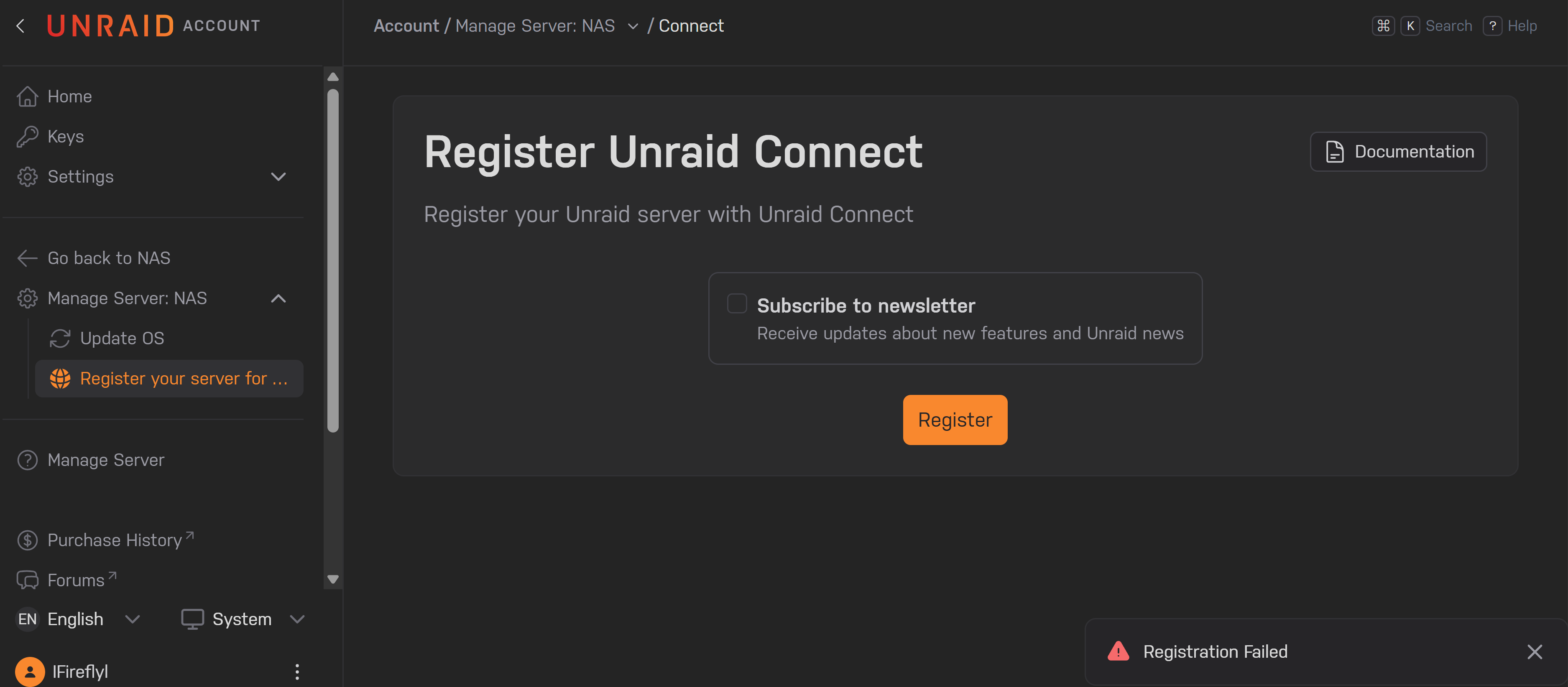

September 7, 2025Sep 7 I'm having the exact same problem... thought I had mucked something up somehow. Going to the Keys page solves nothing. I can see the key but I get the "Registration failed" message when I try to re-register my sever.With Unraid's "Manage Access" page:PS I have a legacy key.
September 7, 2025Sep 7 Nope. Same as many others. Going to the keys page etc does not resolve. Multiple different browsers on different systems yields same Registraion Failed error.
