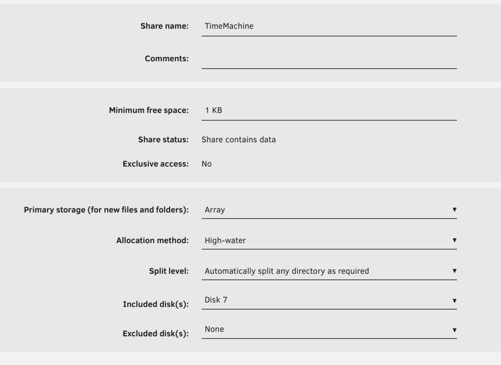

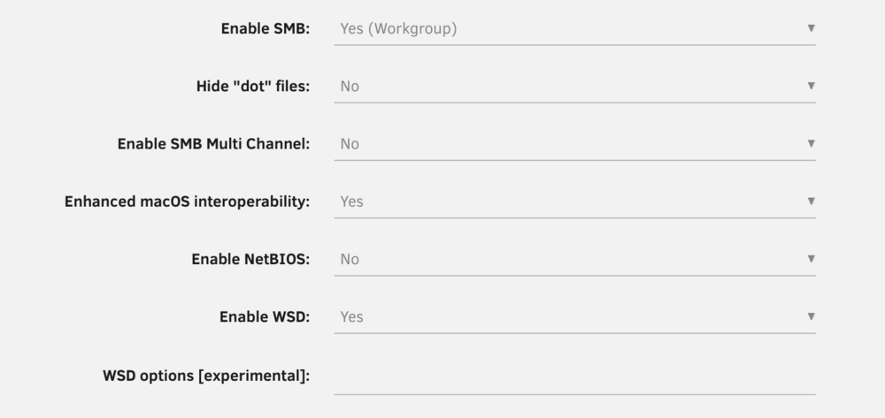

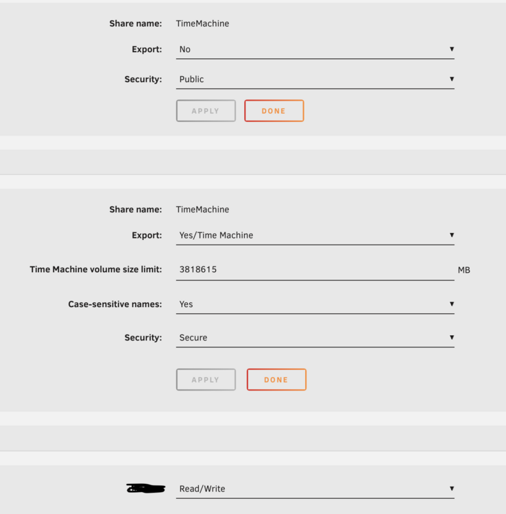

As requested: Settings for TM share;
While TimeMachine is sitting on a ZFS pool, I thought I would try a share on the main array too, just to be sure and I get the same error message of 'The backup disk image could not be created'.

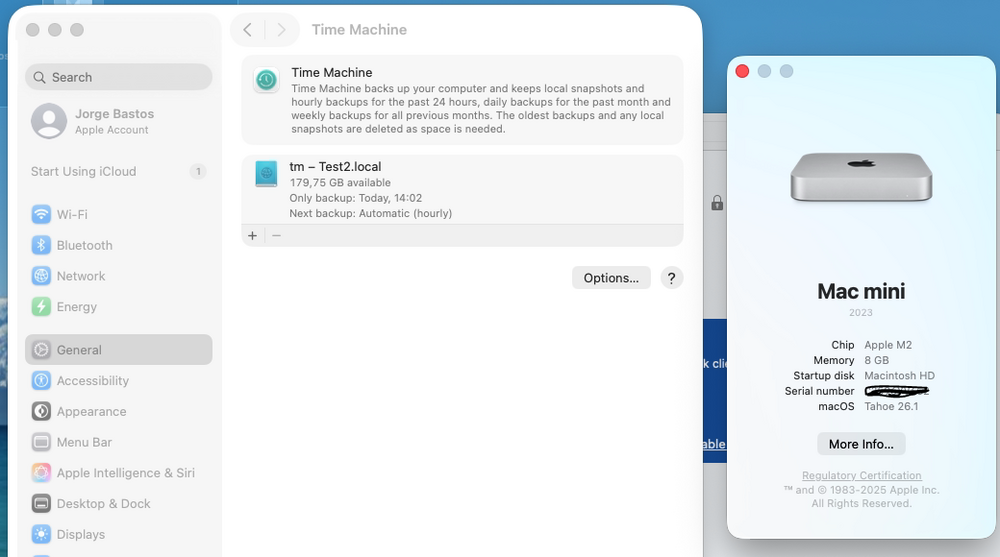

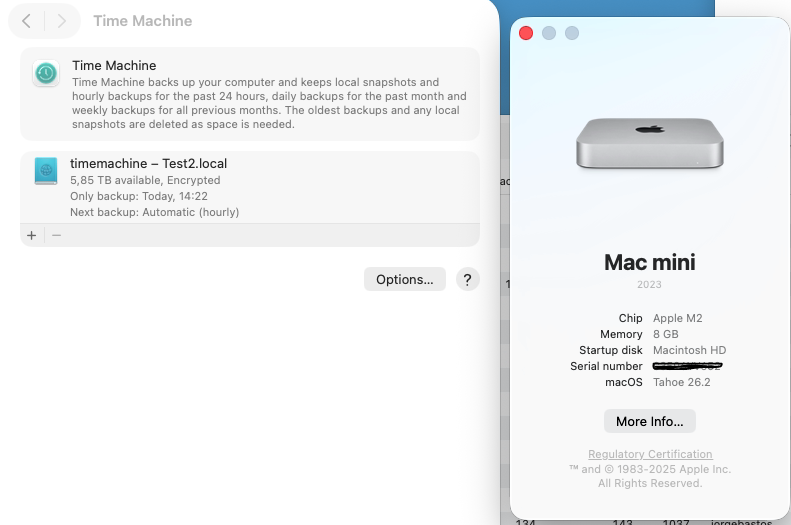

When I can I'm going to update to 26.2 and retest to see if there's any difference, and if it still works for me, I'll see if I can find any difference in the diags/settings.
I've updated Tahoe to 26.2, still working for me, tried backing up to the array, to pools, xfs, zfs, no size limit, size limit, encrypted, not encrypted. I cannot get it to fail...

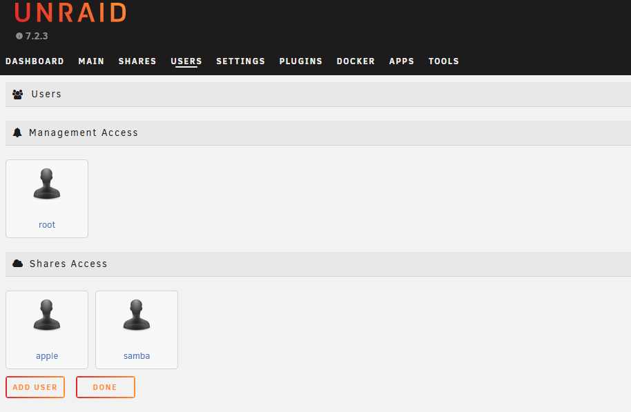

First go to users:
make a dedicated user that will connect to your time machine share. This will be the apple connected user...

While I still cannot reproduce the issue when creating an TM actual backup, but I've found a manual way to trigger the bug, and can confirm it's still present in Unraid 7.2.3, not sure how, since Samba 2.23.4 was supposed to fix exactly this bug, but there's no doubt for me now that it's still there.
LT is aware of the issue and will investigate. Possibly the patch didn't get correctly applied to Samba 4.23.4, only Samba 4.22.7, but now that I can reproduce it 100% of the time, it should be easier to troubleshoot.
Until this is resolved, recommend that anyone who uses TM remain on 7.1.4 or use the container option with 7.2.x
