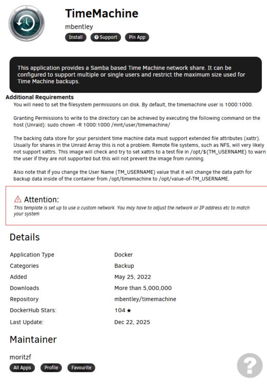

The Solution: Time Machine via Docker The only 100% stable solution was bypassing the Unraid native SMB service and using the timemachine-samba Docker container (mbentley/awlx). This worked perfectly on both my NAS units:
  • NAS 1: Running on XFS.
  • NAS 2: Running on ZFS.
Crucial Steps for 10Gb Stability:
  1. Hardware Fix (Syslinux): For 10Gb cards, I had to add pcie_aspm=off pci=noaer to the Syslinux configuration to prevent PCIe bus errors and log spamming during heavy transfers.
  2. Dedicated IP (Custom br0): Assign a unique IP to the Docker container (e.g., .220). This prevents port 445 conflicts with the Unraid host and provides a "clean" Avahi/mDNS broadcast for the Mac.
  3. Container Path Alignment: This is vital. You must edit the Docker template so the Container Path matches your TM_USERNAME (e.g., /opt/youruser). If they don't match, the Docker will write data into the docker.img vDisk instead of your HD, filling your system disk in minutes.
  4. Permissions: Run chown -R 1000:1000 /mnt/user/your_share/ via terminal before starting the container to ensure the internal Docker user has write access.

I installed the Docker Samba server, and it works flawlessly. In macOS 26.2, the Time Machine control panel immediately recognizes a share on the network that supports Time Machine without the need to mount the share first, which is required when using Unraid shares.
I suggest changing the share name (Advertised Hostname) to "TimeCapsule" and also updating the extra parameter in the advanced view to --hostname TimeCapsule. Using "TimeMachine" as hostname and share mount can create confusion.
Finally, I noticed several errors in the Docker log due to incorrect settings. These should be configured as follows:
SMB vfs objects: fruit streams_xattr
SMB fruit:nfs_aces: no
Additionally, I set the following two settings. They are debatable, but they work great for me:
Set Permissions: false
SMB Inherit Permissions: yes
As for the Docker icon URL, it didn’t work for me, but I found an alternative link with a nice logo.

I was able to install the Docker solution, give it a custom network IP, and configure the mount point fine. I see the mount point and changed ownership to user:group 1000.
The Mac sees the volume as a Time Machine destination (and I can even mount it as a volume and write files/folders to it) but when attempting to configure it in the Settings - Time Machine panel I get:
The selected network backup disk does not support the required capabilities.
Please be sure Time Machine capabilities are enabled on the server for this volume or choose a different network backup volume.
I double-checked and don't think I missed a step. Any idea why this isn't working from a Mac running 15.7.3? Not Tahoe. I've tried mapping the Time Machine volume to both a btrfs and zfs pool.
The docker has its own support thread (click the docker’s icon and select “support”). I would suggest posting any issues there. It’s typically well supported.

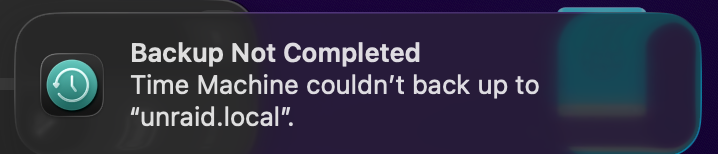

I am on 7.2.4 ZFS and Tahoe 26.4, I am not able to use Time Machine backup. Everything has been working before and now I have no idea which of all of the fix options I should use?
I shouldn't need to run Docker to be able to do a TM backup.
Able to mount it on Mac and add it as a backup, but once I start the backup, it fails immediately
Any ideas?
Update: Just tried to set up recommended Docker, exactly the same result...
Edited by 6103242
TM has been confirmed fixed in 7.2.4 by multiple users, so you are likely having a different issue. Recommend creating a new thread in the general support forum and posting the diagnostics.
6 hours of back and forth with LLMs (F***) and this is what fixed it natively on Unrain TM.
Unraid 7.2.4 - MacOS Tahoe 26.4
sudo /usr/libexec/PlistBuddy -c 'Add :UNRAID_IP_HERE bool true' '/private/var/root/Library/Group Containers/group.com.apple.NetworkAuthorization.ServerMarkers/serverMarkers.plist'
