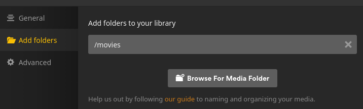

    Click on the plex icon on the unraid dashboard, click on EDIT and then click edit on the Movie path post a screenshot of that because I suspect something For some reason your MOVIE share has a MOV
  • MowMdown
    MowMdown
    Ok well the mystery of two similar shares is solved. it's DOCUMENTS and DOWNLOADS... Both are 9 letters beginning and ending with the same letters. Diagnostics must have confused these two because of

@MowMdown Hi, the MOVIES folder has Subfolders for different types of Movies (ie. Horror; Comedy; Teens; Oldies etc), and has been working fine (for about 5 years) until recently.
I think it happened somewhere around the time that I triggered the update for 7.2.3. It could be purely coincidental, or it could be the cause.
@Mark Holwill
Do you have all your movies under /mnt/user/MOVIES because if not plex wont see them.
With all your screenshots it's not abundantly clear what exact shares and paths you are using. I can only suggest that you double check that ALL your content falls under a single path otherwise you need to add more paths to plex.
Also keep in mine capitalization matters as linux is case-sensitive. /mnt/user/MOVIES and /mnt/user/movies are NOT the same in linux.
Physically go to the unraid shares tab, click on the little blue Box/Arrow next to MOVIES and see if you can see all your files under that share. if not, plex wont either.

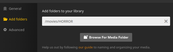

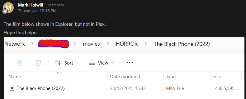

Yeah what threw me off was his post seen below, windows is making movies lower case when HORROR is upper case and his share is upper case as well...
I must've skimmed over the diags. Youre right though, there isn't a lower case movies share.
I still believe this to be a pathing issue within plex. The other way to check is to click on the plex icon, click on console and manually browse the movie share from within and see if the files are visible.

Ok well the mystery of two similar shares is solved. it's DOCUMENTS and DOWNLOADS... Both are 9 letters beginning and ending with the same letters. Diagnostics must have confused these two because of that.
Can you share how you setup your plex movie library inside plex? Do you have a single movie library or did you add a movie library for each of your genre categories like a separate one for HORROR and MOVIES?
I have 8 Movie Folders in Plex! These are: Movies; Teens; Childrens; Horror; Christmas; Elvis; Westerns & Oldies!
Just to be clear. Are these configured as separate libraries in Plex?
As Trurl said, in plex, if you look at your list of "libraries" did you add a separate library for each of the sub-genre folders you have or did you just add one single library for the "movie" directory?
