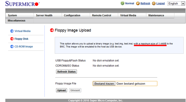

August 20, 201213 yr My board came with bios 1.0... few weeks ago. I cant find if its 1.0a, b or c, it just says 1.0. The dedicated IPMI port is NOT enabled standard on my board. For updating bios, you should be able to mount an ISO through IPMI, the problem is that the ISO can not exceed 1.44MB in size. Now, ive tried formatting an USB stick to 1.44MB, which seems impossible, diskpart also does not allow sizes under 100MB as it seems, and resizing a partition also does not work. So there is no way for me te create a 1.44MB partition on a usb stick so i can convert that stick into an ISO... I guess i will have to plug in the stick in the board then. So far for IPMI...

August 23, 201213 yr We have over a hundred of these boards at work. everyone of them has a working, enabled ipmi port. if it didnt work we'd kick it out as defective to contradict what you said.. Our ISO's are several hundred megs in size. MY board, did NOT use the dedicated IPMI port from scratch. NEITHER was it defective. I never claimed it was defective. It was, for some reason, set up so that IPMI was using the lan1 port. So did other X9SCM boards from others users here. After switching it to the dedicated port using the IPMIView tool, i'm now using the dedicated IPMI port. Furthermore, the IPMI webgui is very clear about the size of a mounted floppy iso. It may NOT exceed 1.44MB. It even fails mounting if you do so...
