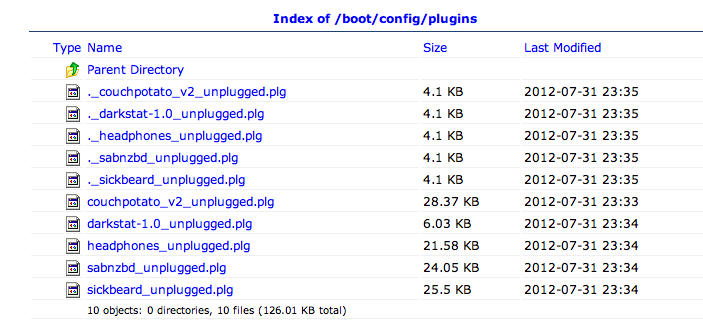

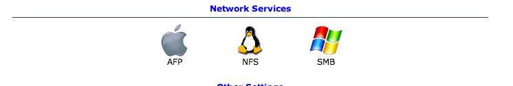

I just set up a fresh install of unRAID Plus with a cache and parity drive (parity is syncing now).
I've added your plugins to /boot/config/plugins/ on the flash but they don't appear under the network services. Any ideas?
Did you reboot after adding them, or run them manually?  If not they won't run until you do.  To run them manually issue the following:
installplg /boot/config/plugins/plugin-name.plg
Where plugin-name.plg is the name of the plugin
Excellent, that got them to appear. Now to try and configure them :-S Is there a guide for configuring them correctly?
