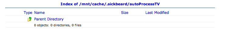

For some reason Sickbeard isn't creating anything in the autoProcessTV directory. I've tried restarting Sickbeard and unRAID.
What are your download and install directories set to?
Tybio - I think I skipped the dev branch altogether on that one, try the sab plug-in in the master branch. Also, does the GUI hang when trying to stop the array? If so try /etc/rc.d/rc.sabnzbd stop and post the output if it fails.
Apps are set to /usr/local/**app**
Data is set to /mnt/cache/.**app**
Sickbeard's autoprocess files are in the install directory, so they should be in /usr/local/sickbeard/autoProcessTV/
You only need to copy them to the data directory once, make the needed changes, and you will be good to go.
cp /usr/local/sickbeard/* /mnt/cache/.sickbeard/autoProcessTV/
