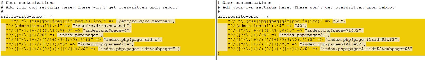

Replace the lighttpd.cfg with the one found in my post a couple pages back.
yours will be located in /boot/config/plugins/simpleFeatures/
Also make sure that if the newznab directory is set to /mnt/cache/newznab/ that in simplefeatures the web-root is set to /mnt/cache/newznab/www/
I did a compare of the lighttpd.cfg file the plugin created on my system vs the known good one.  As you can see there are differences.  The version on the left was created by the plugin.
Thank you for that, it is fixed in new version. Moved over to my plug-in repo, download plug-in HERE!!!
