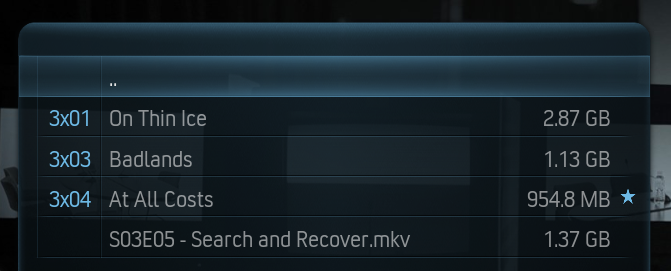

A couple of shows downloaded last night (Falling Skies and True Blood).  They have been added to the library from what I can tell but they are not added like I would expect.  See the attached photo for what I mean.
Basically, the first three were put into the system by using the "update library on startup" while the last one was put into the database via SickBeard and the xbmc salud process.
Does anyone know the reason why the update to the library would be different?
