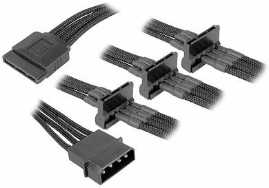

MMMMmm
One of these things is not like the other

MMMMmm
lol nice catch :)
I suspect both of the leftmost wires are grounds ... so it makes no difference if they're crossed.
DANGER WILL ROBINSON!!!
Per this diagram: http://media.bestofmicro.com/Power-Supply-Fundamentals,8-I-312642-13.jpg they have crossed a 12v and gnd wire.  I would NOT use that cable and I would return it for a replacement.
The only way to know for sure that it is a crossed connection is to test it.  It could be crossed internally inside the plastic then crossed again to make a proper connection outside.  If it truely is crossed then a continuity test would show if the same pin on the input connector is connected to the same pin on the output connectors.  Personally I think it is a crossed connection and should be returned but a test should prove it.
That would mean they noticed in manufacture that they screwed up once on the internal piece, and then decided to correct it via external crossed wires again vice just tossing it.  It certainly was not a post-production manual fix.  But still not impossible I guess [shrug].  I would certainly be VERY interested to find out the results of a test especially if it turns out that it test correctly :o
True.  My thought was that the wiring was all assembled first then the plastic covers were molded/stamped onto it.  If the plastic covers are pre-manufactured and slipped on in construction then there would be almost a zero percent chance that it would work.
I have an email out to their tech support... I would really doubt they would correct an internal layout issue with the line out.

The crossed wire one is a manufacturing defect according to silverstone.
So... I decided to test continuity across the lines per gary's spec link. on the good one ... and ... one of the grounds did not complete it's path through the molded connector
all confidence shaken, both returned.
