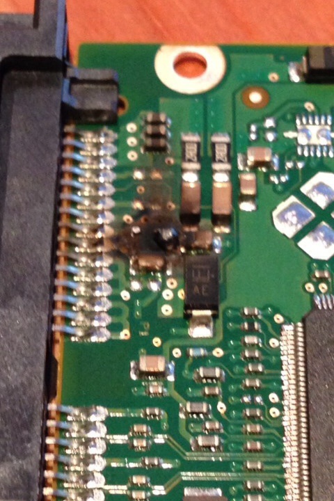

So the drives are fried. Out of the 8, 3 drives are ok. Looks like I put -12v across the drives and pop!

Sorry to hear that.  The "good" news is that the voltage almost certainly killed the drive's PCB, but it's unlikely it harmed the platters or the heads.    From a recovery perspective, that's actually a fairly easy recovery ... so you just may be able to get this done at the £120+vat price => and it's very likely that ALL of the data will be recovered.    Be sure the company knows that the data is in ReiserFS format ... and let them know what happened, and they should be able to confirm whether or not they can do it at that price.

If you really did get lucky and only fried the controller board then you can buy an identical drive new, swap the board, recover the data,  swap the board again, and use the new drive in the array. I've done it, after a lightening strike, it can work.
Sent from my Nexus 7 using Tapatalk 4
Agreed,
If you have 2 identical drives (model and manufacturer) you can move the controller board (PCB) from the working HDD to the "bad" HDD (after saving all data from the working drive) and try accessing the drive again.
If nothing then switch back the PCB to the working drive - no harm done.
It is usually all external to the HDD - you don't need to open the HDD for this.

No they aren't, on of the 0v and 12v connections were reversed. Which is what blew the pcbs. The cables look the same in that they are braided and heat shrieked right up to the connectors so you can't see the colours of the wires. I'm taking server all things away from this incident. Namely:-

Did you also consider replacing the PCBs as you seem to be a technical person (electrician)?
I have talked to the company offering the fixed price recovery. They offer a no data, no fee policy so in that respect I have nothing to lose. They seem very confident that they can do it and their outfit looks respectable (all the right company numbers, VAT registration, an actual unit that they work from. I have visited the trade counter and it certainly feels like they mean buisness etc).
My plan is to try them with the smallest fried drive (500gb) to see if they could do it. There isn't much on it and if they do mess it up then so what.
Yeah I going to try it. There shouldn't be a problem with the swap. I have 2 drives that are same make and model, one dead one alive. I'm going to get the data off the good one and then try the PCB swap. Who knows, it might work...
The PCB has to be the exact same revision with the same firmware -- but if that's true there's an excellent chance it will work.
I'm not really sure, since there is no more logic outside the PCB.
It should be indifferent to the drive mechanics what firmware is on.
Of course, assuming its the same model and the same mechanics inside.

Just an update on my progress. Out of the 10.5TB of data I have now got 3.5 recovered. Its slow progress but i am confident i will be able to recover more. I'll keep you posted.
Glad to hear there's progress -- are you doing this by PCB swaps, or are you using the data recovery outfit you found?
A bit of both. I am trying to swap out the pcbs first and if that fails the sending them to the recovery company.
So far I have recovered 3x drives myself by swapping the pcb and have sent 1 do be recovered (only because I can't find a suitable pcb ANYWHERE!). Once the pcb is swapped I'm using using FTK imager to pull the data onto my desktop and then onto my new unraid.
The pic is one of the pcbs. Each one looks to have the same signs of damage.
Glad to hear that PCB swaps are working so far. I seem to remember reading somewhere about replacing these sacrificial TVS diodes on the HDD PCB. Not sure if that would work here or not, but might be worth a shot if you can do some basic soldering. Certainly cheaper than getting replacement PCBs or data recovery.

All my data is now back. I used a company in the Canada (anyone need to know PM me) for the replacement pcbs. They charged $49 for the boards with free postage and free bios transfer.
