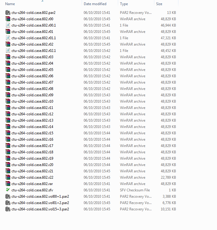

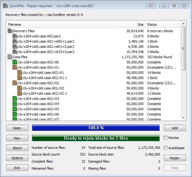

Ok, I found a problem with Sab, and decided to get the logs, etc to see if the issue can be fixed.
The resulting file can be repaired with QuickPar, files would appear to need rejoining, which Sab seems to fail to do.
I've attached the log file for this download only, along with a couple of screenshots.
Hope this helps.
Glen.
CC3.zip
Attachment was too big to include the pictures, so here they are...
and finally..
The files repaired correctly by opening a telnet session, and typing par2 r ctu-....vol00+1.par2

Target: "ctu-x264-cold.case.602.r01" - damaged. Found 14 of 15 data blocks.
Target: "ctu-x264-cold.case.602.r02" - damaged. Found 14 of 15 data blocks.

2 file(s) exist but are damaged.
22 file(s) are ok.
You have 350 out of 352 data blocks available.
You have 6 recovery blocks available.
Repair is possible.
You have an excess of 4 recovery blocks.
2 recovery blocks will be used to repair.
Computing Reed Solomon matrix.
Constructing: done.
Solving: done.
Wrote 100000000 bytes to disk
Verifying repaired files:
Target: "ctu-x264-cold.case.602.r01" - found.
Target: "ctu-x264-cold.case.602.r02" - found.
Repair complete.
