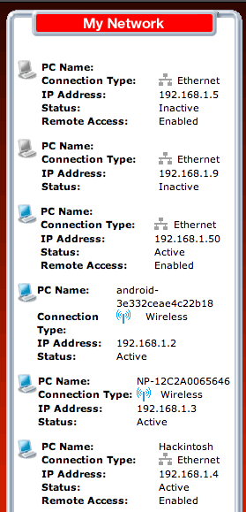

Yes, That much I do know.  I have just accessed the router.  The unRAID box is not showing in regards to having a IP address.  What now?
Oh, sorry, it may not be 'called' unraid.
Attached is a screenshot of my local network. (fios)
Unraid is simply identified as an 'ethernet' device. (in my screen shot, its #50)

...So your router is #192.168.1.1, and (if you have only one PC and the unraid box on your local network) your PC shows up as #192.168.1.2, etc.  Do you recognize all the other devices...and by process of elimination, know which one is new?
Or how about this, what's the LARGEST number? something like 192.168.1.7
Try that. (the numeric addresses are created in the order in which your PC's, etc. are powered up and connect.)
Type the LARGEST number in to the browser.. (all 192.168.1.xx  of it. )
