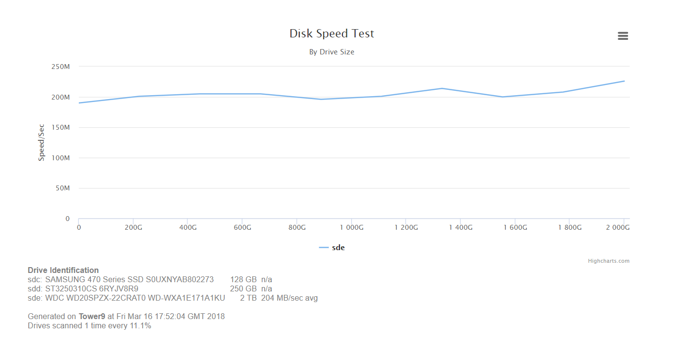

WTF? How is this possible? This is a WD 2TB blue mobile 2.5", and it's not the plugin as I confirmed the results with other utils.
Very nice transfer speed. But 2.5" drives can use higher data density because the platters are smaller and so introduces better mechanical tolerances, less vibrations etc. At the same time, a 3.5" drive has the head optimized for the middle part of the media so they need to reduce the data density on the outside tracks or the bit rate (frequency) becomes too high compared to what the drive heads are designed for.
That's also why they killed off the 5.25" drives - they couldn't keep up with the data densities of the 3.5" drives.
The main issue with 2.5" drives is that they are so thin that they can't have as many surfaces as 3.5" drives - one of the reasons why lots of 2.5" USB drives uses extra-thick drives.
Anyway - it will not take too many years before the 2.5" drives will leave the 3.5" drives in the dust. The best 2.5" drives are 5TB and have been for about two years now so soon time for a new high score. So they are right now about half the size of the best 3.5" drives.
Yeah, but I still don't get how it's possible to the speed to remain constant as it goes through the inner cylinders, I believe this disk uses SMR, so there's a faster PMR zone, still all SMR disks I've tested before act like a normal disks, i.e. if the transfer speed starts at 200MB/s it should end at around 100MB/s, not stay constant, I need to make more tests.
Yes, the inner tracks should drop off.
I tried to find any benchmarks but failed to get any matches on WD20SPZX, WD20NPVZ and WD15NPVZ. Just sales talk or references to much older WD drives. And WD only shows the interface bandwidth (6Gbit/s) in their datasheet.
Maybe the SMR means you fail to store data on the inner track because you haven't filled the drive full and whatever address you specify for your transfers ends up being mapped to an outside track?
That's what I was thinking since the disk was has never been written to.
I'm interested in the outcome of this. That would then mean we can't easily plan where to locate our critical data to optimize for bandwidth. If they use mapping logic, then it wouldn't even be sure that we can create four 500 GB partitions to force fast and slow regions.
Or maybe the unshingled region is large enough that the drive hasn't spilled over to the main storage region yet (while WD might have decided to take a bit of advantage of their unshingled region to "unintentionally" boost benchmarks).

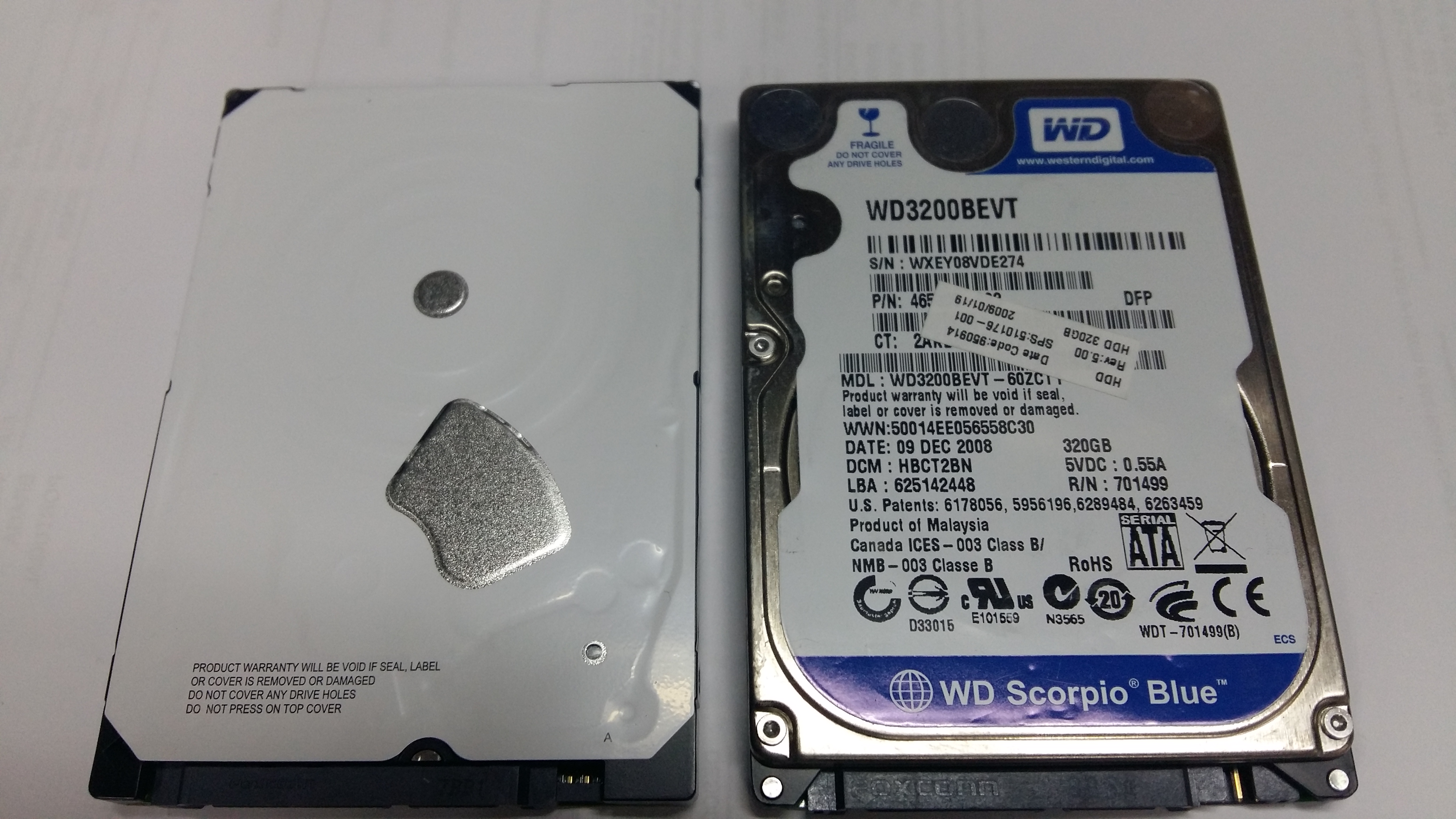

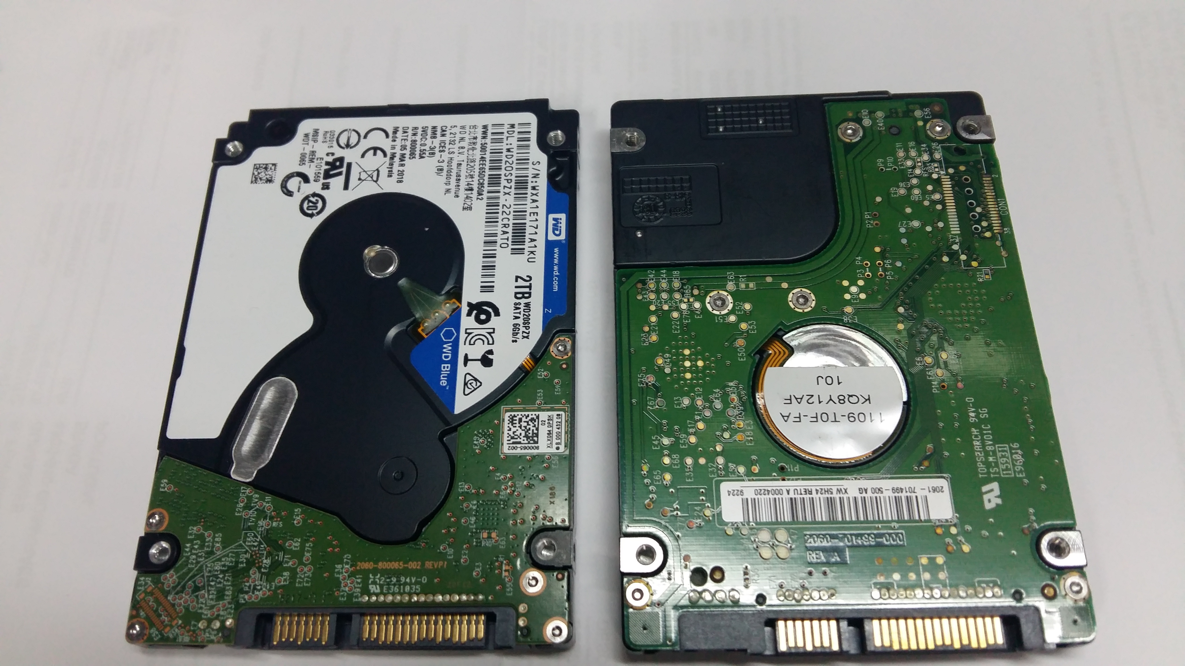

I do more testing after writing to full capacity, the disk does look weird, the platters are not on the usual place, but they are still round :)
5aac14df1fdd1_2018-03-1618_58_11.thumb.jpg.1cc8430316faa0b17be80a188639a4ca.jpg5aac14c717ac1_2018-03-1618_57_47.thumb.jpg.07eae4eb366d97e687cb28ef7047b737.jpg
Interesting. Looks like it's using smaller platters suitable for a 1.8" drive. Similar to how lots of high-end 3.5" drives have used 2.5" platters for a long time now.
Maybe my guess that it isn't too far until 2.5" drives will replace the 3.5" drives was wrong. Maybe they jump all the way to 1.8" drives. :ph34r:

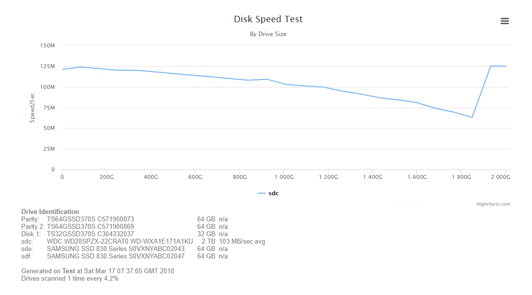

Another run after filling the disk up, disk looks more in line with what I was expecting, still a weird uptick in the end:
5aacc69962b86_Screenshot2018-03-1707_37_34.thumb.png.ded134e920a56955c0d284a9cb783f0d.png
WD is doing some kind of weird sector mapping, and it's not just because SMR, as Seagate Archive drives behave like a normal disk in this test since new, even before they are written to.
Interesting. The only other reason I can think of is somehow the drive's bandwidth is being capped but the drive can still exceed it from end to end.
This mapping logic doesn't make any sense.
