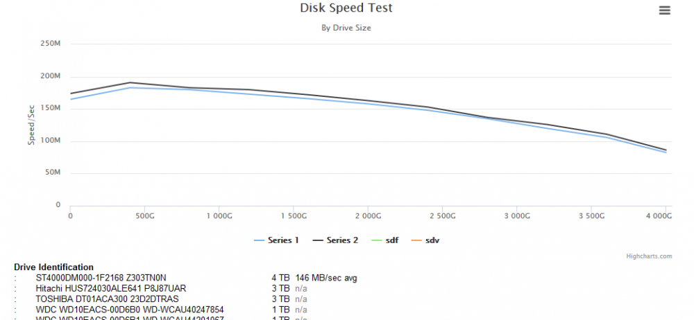

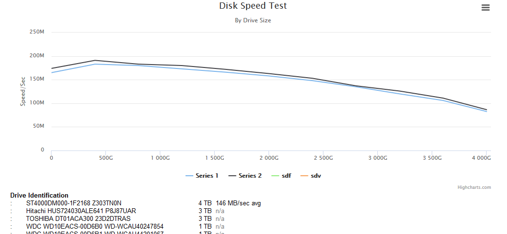

The html file in the zip file you sent had graphs. Are you not seeing it? The straight HTML you sent attached did not on my end and the text was all grey.
  • Replies 458
  • Views 109.3k
There's definitely a bigger issue here in that it's not able to detect many of your drive assignments or UNRAID slots.
ETA: Actually, it did detect the drive assignments but it's listing all the drives twice. I'll need to dig into this one. Are you running the most recent version of the script?

Bah, I see that now too. The original plugin-generated one however is not working for me in chrome or FF. I regretfully did not have the foresight to save a copy of the full script run, not realizing it got overwritten by the 2nd smaller run.
I'll run the full script again.
Question: why do my drives appear twice under the drive identification area?

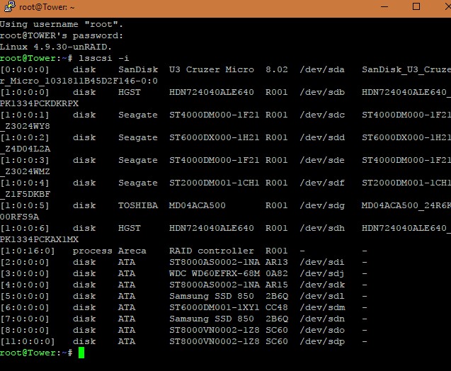

root@Unraid:~# lsscsi -i
[0:0:0:0]    disk    SanDisk  Cruzer Fit       1.27  /dev/sda   SanDisk_Cruzer_Fit_4C530012270322105470-0:0
[1:0:0:0]    cd/dvd  HL-DT-ST BDDVDRW GGC-H20L 1.03  /dev/sr0   HL-DT-ST_BDDVDRW_GGC-H20L_123456789C5F-0:0
[2:0:0:0]    disk    ATA      TOSHIBA DT01ACA3 ABB0  /dev/sdb   -
[2:0:1:0]    disk    ATA      TOSHIBA HDWD130  ACF0  /dev/sdc   -
[2:0:2:0]    disk    ATA      TOSHIBA HDWD130  ACF0  /dev/sdd   -
[2:0:3:0]    disk    ATA      WDC WD10EACS-00D 1A01  /dev/sde   -
[2:0:4:0]    disk    ATA      ST4000DM000-1F21 CC54  /dev/sdf   -
[2:0:5:0]    disk    ATA      TOSHIBA DT01ACA3 ABB0  /dev/sdg   -
[2:0:6:0]    disk    ATA      Hitachi HUS72403 A5F0  /dev/sdh   -
[2:0:7:0]    disk    ATA      Hitachi HUS72403 A5F0  /dev/sdi   -
[2:0:8:0]    disk    ATA      TOSHIBA DT01ACA3 ABB0  /dev/sdj   -
[2:0:9:0]    disk    ATA      WDC WD10EACS-00D 1A01  /dev/sdk   -
[2:0:10:0]   disk    ATA      Hitachi HUS72403 A5F0  /dev/sdl   -
[2:0:11:0]   disk    ATA      TOSHIBA DT01ACA3 ABB0  /dev/sdm   -
[2:0:12:0]   disk    ATA      WDC WD10EARX-00N AB51  /dev/sdn   -
[2:0:13:0]   disk    ATA      WDC WD10EACS-00D 1A01  /dev/sdo   -
[2:0:14:0]   disk    ATA      TOSHIBA DT01ACA3 ABB0  /dev/sdp   -
[2:0:15:0]   disk    ATA      TOSHIBA DT01ACA3 ABB0  /dev/sdq   -
[2:0:16:0]   disk    ATA      SAMSUNG MZ7WD480 NS00  /dev/sdr   -
[2:0:17:0]   disk    ATA      TOSHIBA DT01ACA3 ABB0  /dev/sds   -
[2:0:18:0]   disk    ATA      ST3000DM001-1ER1 CC43  /dev/sdt   -
[2:0:19:0]   disk    ATA      WDC WD10EACS-00Z 1B01  /dev/sdu   -
[2:0:20:0]   disk    ATA      ST4000DM000-1F21 CC54  /dev/sdv   -
[2:0:21:0]   enclosu LSI CORP SAS2X36          0717  -          -
[2:0:22:0]   disk    ATA      ST4000DM005-2DP1 0001  /dev/sdw   -
[2:0:23:0]   disk    ATA      ST4000DM005-2DP1 0001  /dev/sdx   -

1 hour ago, jbartlett said:
Does the command "lsscsi -i" reveal the information?
yes it appears to list them all.
Excellent. I'll add logic to get the last column from lsscsi if other methods do not reveal it. I'll post a test script for you to try to see if the logic works with your setup.

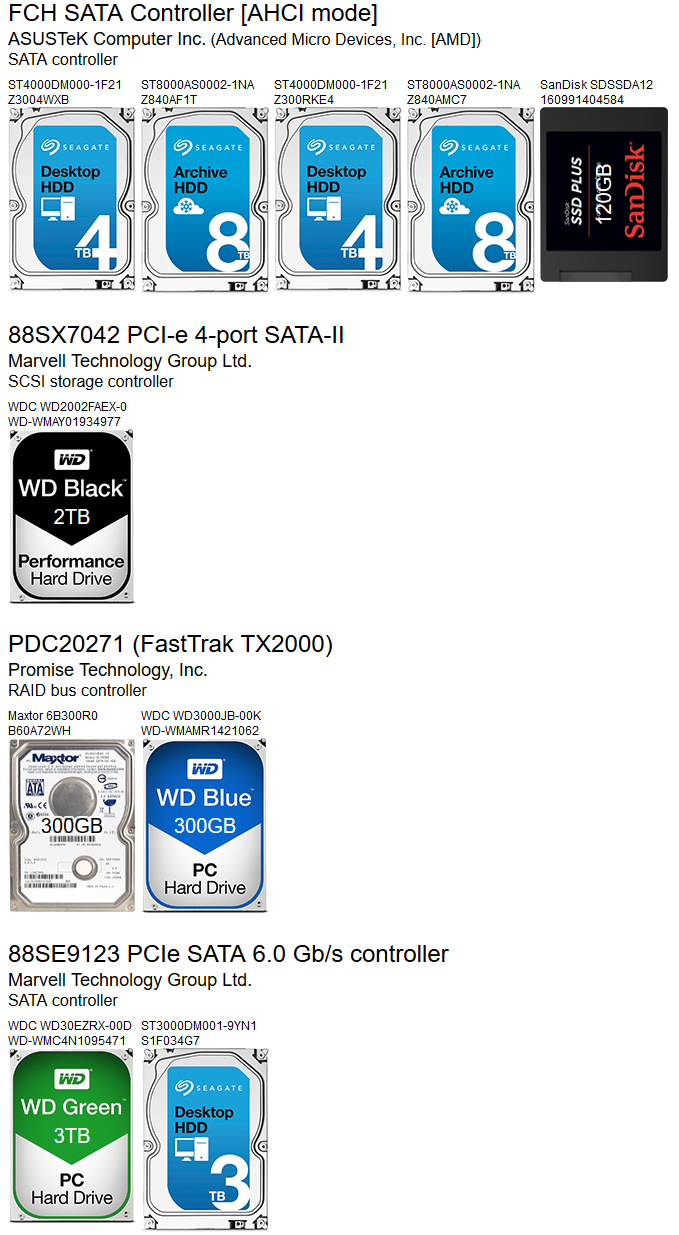

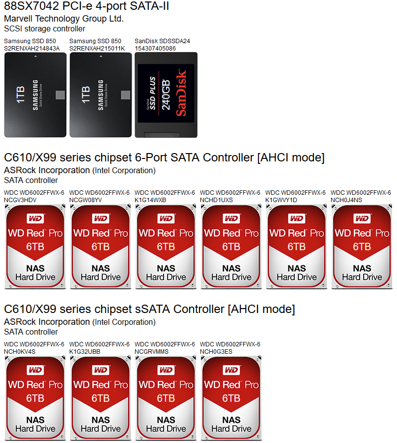

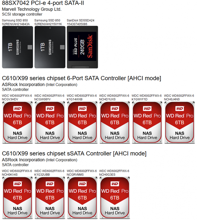

I'm making good progress on the next version but I'd like to get your help in populating a collection of drive models. I currently have details on over 300 Western Digital & Seagate drives 1TB and larger along with a few scattered ones to complete my own personal set. The time consuming part is finding the model numbers and a image representation of that drive to display instead of a default/generic drive image. If you'd like to help and to ensure your run is more pleasant, please run the attached "diskmodels.sh" script. What it does is to send the drive models of the drives you have connected to a web site app and it'll return either it was added, previously added, or contains unexpected characters. I've spent the past 4 days working on the drive model database and I'd rather work on the website code for now so any help on getting models for non-Seagate/non-WD or old no-longer-sold drives in use will help.
If the diskmodel.sh execution of "lshw" seems to be running very slow (more than a couple seconds), spin up your hard drives.
The drive information list contains the model number, along with interface, RPM, and cache size if known. The rest of the drive details (not displayed yet in the images) is fetched from the OS itself.
To Do:
  • Display full controller information
  • Display full drive information including which port it's hooked to on the controller
  • Perform bandwidth tests on a controller using one and more drives
  • Perform speed testing on one or more drives, allowing 1 drive per controller to be tested at the same time
  • Display speed results in a graph with optional historical graph comparison from past runs to see if the drive is performing worse over time
  • Display a heat map of the drive and hopefully a heat map of the drive by platter
I'm developing this on an UNRAID server running a Lucee (ColdFusion app server) self-contained install and will see about porting it to PHP in the RC phase. I've been coding in ColdFusion since 1998 so I can develop code fast but I haven't done much development of new PHP code, just modifying existing apps. In the plugin app itself on the UNRAID GUI, the user will have the option to enable/disable the Lucee server as the server itself will use up to 256MB of RAM in addition to however much file space the app server takes - so it won't run on a system with less than 2 GB of available RAM (1.25GB of that is for the speed testing itself).
I'm pretty excited about this project. It seems like there's nothing else out there like it. The closest thing was an old text-only app.
Attached are screen shots of my two UNRAID systems listing the controllers & the drives attached to those controllers.

I ran your diskmodels.sh and this was my output.
is that what you are looking for?
Checking model [HGST HDN724040AL] - Added
Checking model [ST8000AS0002-1NA] - Previously added
Checking model [Cruzer] - Added
Checking model [Samsung SSD 850] - Previously added
Yup! I don't need C&P of the runs but I do see that you & others have ran the script. The Cruzer is probably your USB drive, they've been a bit harder to trace in the OS /sys/devices tree so they're not in yet. I wouldn't be able to do more than a generic brand icon for "Cruzer" anyways. But I do plan on adding support for putting in your own drive image and optionally overlaying the drive size over the image with the ability to position, rotate & highlight the text to best fit the image.
Ran your script, 7 added. Keep up the good work.
diskmodels.sh
@jbartlett
What tool did you use to product this output?
