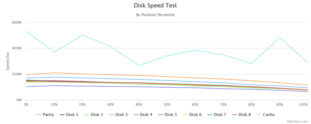

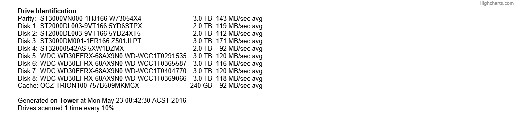

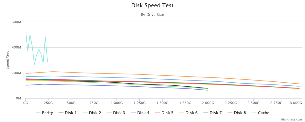

Finished my first lot of testing today.
/dev/sdb (Disk 1): 119 MB/sec avg
/dev/sdc (Disk 3): 171 MB/sec avg
/dev/sdd (Disk 2): 112 MB/sec avg
/dev/sde (Parity): 143 MB/sec avg
/dev/sdf (Disk 7): 120 MB/sec avg
/dev/sdg (Disk 5): 120 MB/sec avg
/dev/sdh (Disk 8): 118 MB/sec avg
/dev/sdi (Disk 6): 116 MB/sec avg
/dev/sdj (Cache): 382 MB/sec avg
/dev/sdk (Disk 4): 92 MB/sec avg
Am going to run a extended smart test on sdk as there is no reason for the drive to be that much slower than the rest.
Edit : "Seagate Barracuda LP 2 TB 5900RPM SATA 3 GB/s" that may have something to do with the speed lol.

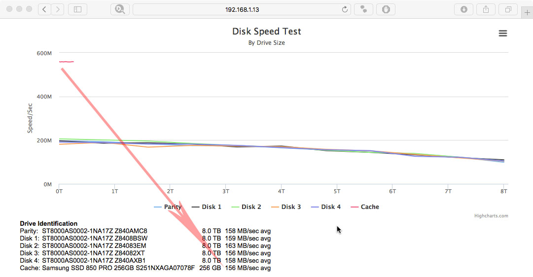

I'm trying to figure out why unrars aren't hitting cache speed (and unrar'ing seems to choke the system - everything *should* be on cache, but system stats during unrar are more consistent with array drive speeds and WebGui becomes unresponsive, and nope, doesn't seem to be CPU or RAM).
In the process, I got this interesting result from the diskspeed graph...
CLI output is
diskspeed.sh for UNRAID, version 2.4
By John Bartlett. Support board @ limetech: http://goo.gl/ysJeYV
/dev/sdb (Cache): 558 MB/sec avg
/dev/sdc (Disk 4): 158 MB/sec avg
/dev/sdd (Disk 1): 159 MB/sec avg
/dev/sde (Disk 2): 163 MB/sec avg
/dev/sdf (Parity): 158 MB/sec avg
/dev/sdg (Disk 3): 156 MB/sec avg
and then, that confusing little line on the bottom - is it a bug in the script, or is there something else at play I'm missing here ?
Are you trimming your SSD? in my experience Samsung SSDs writes are terrible without trim.
Thanks for the hint - normally, I *should* be... what I don't quite get is if I borked my config somehow, and ended up with a parity-protected cache drive or something stupid, or if there's something else at play that generates that bottom result.
No, your SSD is assigned to cache, so it can't be part of the array, the correct read speed is the one shown on the graph, but by what you describe what you have are slow writes, by default cache is not trimmed, you have to install the dynamix trim plugin.
Awesome, thanks !

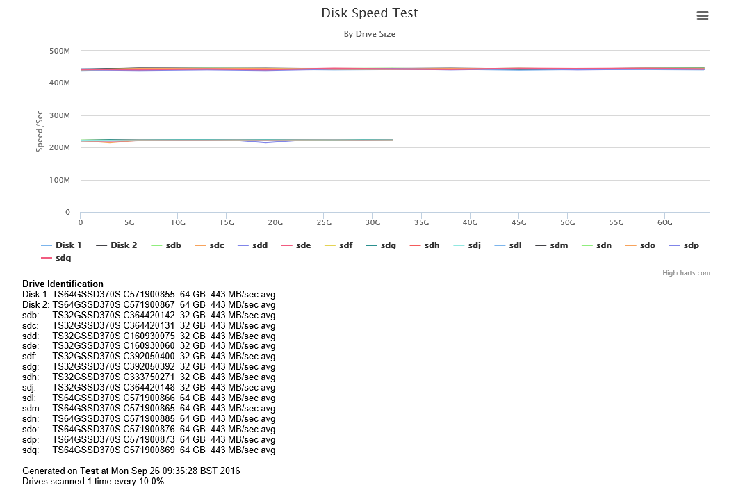

Thanks, used it on my test server, graph is correct but results below are not.
Edit: results on the console are correct:
diskspeed.sh for UNRAID, version 2.6 beta
/dev/sdb: 223 MB/sec avg
/dev/sdc: 221 MB/sec avg
/dev/sdd: 221 MB/sec avg
/dev/sde: 221 MB/sec avg
/dev/sdf: 222 MB/sec avg
/dev/sdg: 223 MB/sec avg
/dev/sdh: 222 MB/sec avg
/dev/sdi (Disk 1): 443 MB/sec avg
/dev/sdj: 222 MB/sec avg
/dev/sdk (Disk 2): 443 MB/sec avg
/dev/sdl: 441 MB/sec avg
/dev/sdm: 444 MB/sec avg
/dev/sdn: 443 MB/sec avg
/dev/sdo: 443 MB/sec avg
/dev/sdp: 441 MB/sec avg
/dev/sdq: 443 MB/sec avg
Inventory list is giving the same speed on what it thinks are unassigned drives. Odd, I'll check into that. Thank you!
