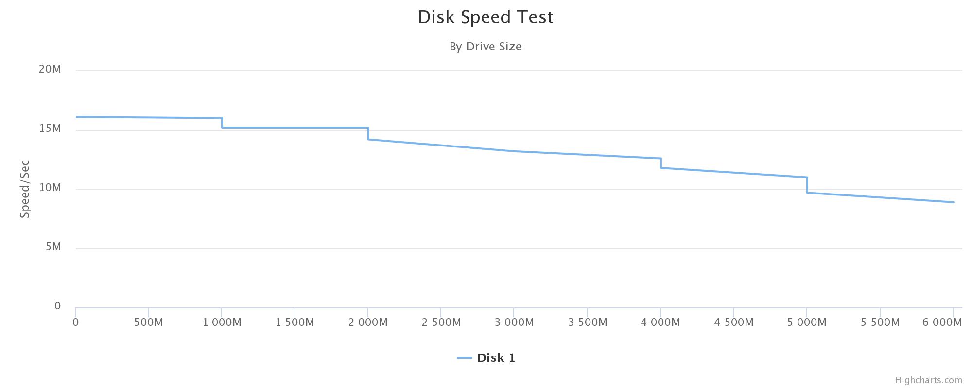

Just for kicks, a very old disk, anyone got a slower one? B|
...maybe an USB1.1 drive :)
Why are those "stairs" in the graph?
It's and old 6.4GB IDE PATA disk, stairs I believe are because the disk is too small so samples overlap.
