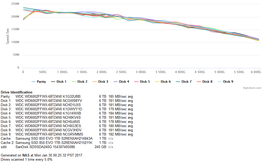

Finished upgrading my Seagate 4TB drives to WD Red Pro 6TB (full set) and immediately upgraded to RC9 and then ran a test - which is how I found out the script was broken in RC9.
Interesting that some of the drives show the same "Seagate Drop" at the start but not all.
I really am pleased with these drives but they do run a little hot. Plan accordingly.
