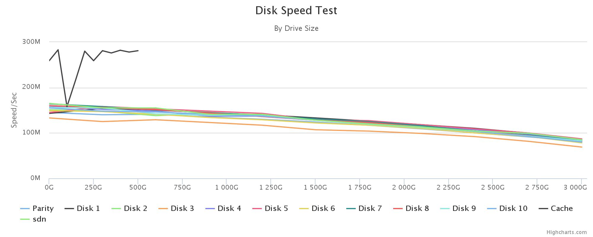

I'd be more concerned about the results for your SSd's  :o
  • Replies 458
  • Views 109.3k
I think it is a bug. The graphical chart shows the correct SSD speeds being 545MB/sec but the text isn't correct.
