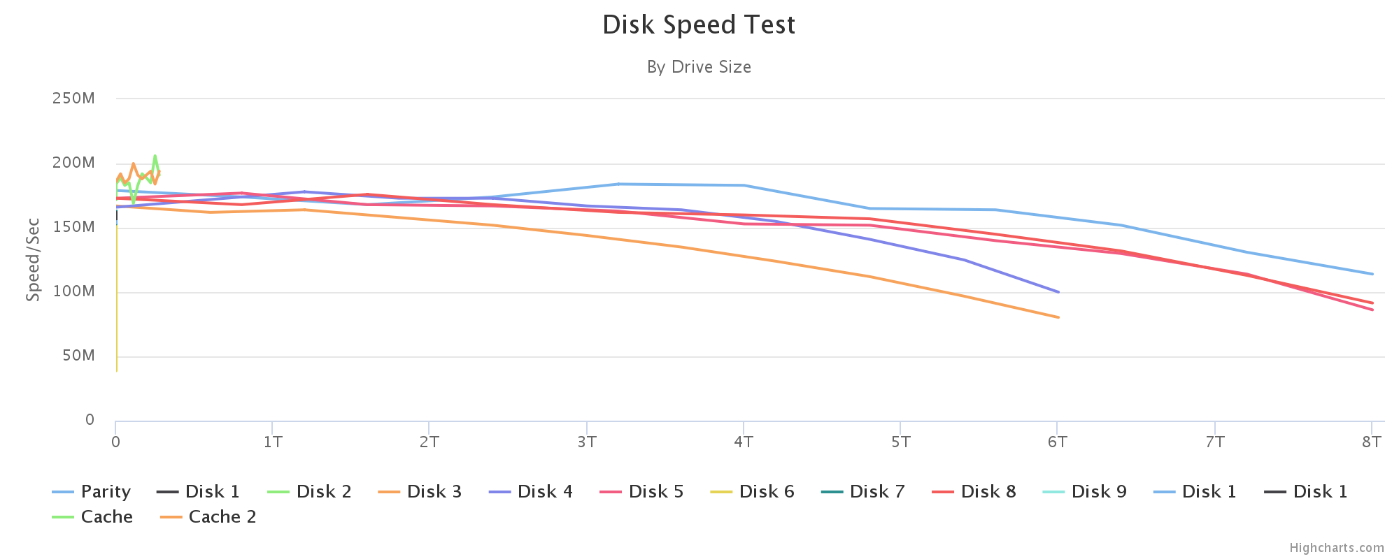

Seems we have lost drive size on the (Moo) Areca-connected drives. Also it labeled 3 different drives as Disk 1.
PS> The 2 extra drive 1 are 10 & 11. :) missing digits.
Drive Identification
Parity: ST8000VN0002-1Z8112 ZA124ASG  8.0 TB   162 MB/sec avg
Disk 1: Moo MD04ACA500_24R6K00RFS9A    138 MB/sec avg
Disk 2: Moo ST6000DX000-1H21_Z4D04L2A    179 MB/sec avg
Disk 3: WDC WD60EFRX-68MYMN1 WD-WX51D6402971  6.0 TB   135 MB/sec avg
Disk 4: ST6000DM001-1XY17Z Z4D23K9N  6.0 TB   155 MB/sec avg
Disk 5: ST8000AS0002-1NA17Z Z840J4R8  8.0 TB   147 MB/sec avg
Disk 6: Moo HGST_HDN724040ALE640_PK1334PCKDKRPX    147 MB/sec avg
Disk 7: Moo HDN724040ALE640_PK1334PCKAX1MX    160 MB/sec avg
Disk 8: ST8000AS0002-1NA17Z Z8406M0L  8.0 TB   149 MB/sec avg
Disk 9: Moo ST4000DM000-1F21_Z3024WY8    157 MB/sec avg
Disk 1: Moo ST4000DM000-1F21_Z3024WMZ    155 MB/sec avg
Disk 1: Moo ST2000DM001-1CH1_Z1F5DKBF    159 MB/sec avg
Cache: Crucial_CT275MX300SSD1 163313AAF7EE  275 GB   186 MB/sec avg
Cache 2: Crucial_CT275MX300SSD1 163313AAFC71  275 GB   190 MB/sec avg
Generated on Tower at Mon Oct 10 13:27:49 PDT 2016
Drives scanned 1 time every 10.0%

That's why. My script is coded to look for id's that are 3 or 4 characters long. I didn't even know they could be anything else! I'll change the logic to grab the second value by space and then drop the : off at the end. What I should have done from the start.
And exclude loopbacks and MD devices (which are mapped to a physical device)

has anyone tried using diskspeed to test against one or two disks rather than the whole array? Do you have to exclude all except the 1 or 2 drives? Just wondering if this was user error on my part or if others experience this as well.
diskspeed.sh -s 11 -5 -o diskspeed3tb.html -x sda,sdb,sdd,sde,sdf,sdg,sdh,sdi,sdj,sdk,sdl,sdm,sdn,sdo,sdp
as you can see it still tried to do the drives I excluded

Sounds like a bug got in there, I'll check it out.
