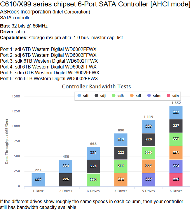

Development on the new version is plugging along, slowly but surely. I'm currently working on bench marking controller cards. Here's the controller bandwidth test results for one motherboard controller on my main server with 6 Red Pro drives attached - and capacity wasn't maxed. I think I'll need to hook up a bunch of SSD's to my LSI 8 port card. In theory, once capacity has been maxed on the controller, the amount of data being read by each drive would shrink while the total data being read from all drives combined remained the same.
Edited by jbartlett
Limit here is going to be the DMI bus, around 1500/1600MB/s.
You'll need SSDs, max bandwidth if it's a SAS2008 variant is around >2500MB/s.

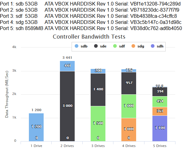

Here's a graph with the app running under VirtualBOX with each virtual drive running on a Samsung 960 EVO M.2 500GB NVMe. This is a good example of maximizing the controller that is not running optimally.

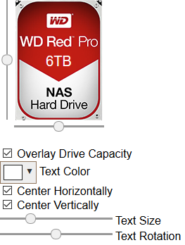

On initial first-time run, the app will fetch the model information from my server for each brand and will pre-set the drive image based on the first image found. If no information was found on the drive model, a generic drive image will be used instead.
The goal is to let you upload a new image, specify if you want to overlay the drive capacity over the image, and if so, the size, position, and rotation of the text. You'll have the option to upload your drive image and overlay settings (if any) to my central repository.
Another way to select drive images is to get a view of every available drive image and select the one you want to use. Examples are when a brand such as Western Digital uses one basic image for an entire model line (think WD Black) but then later comes out with a new style for it. You'll be able to select between them.

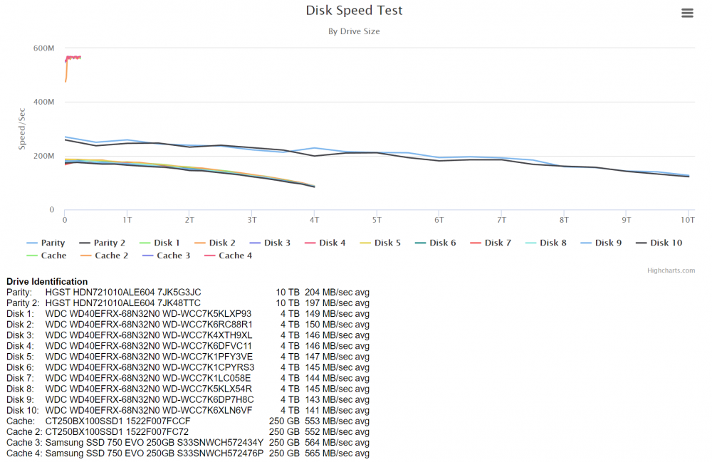

Recently I purchased new 10TB drives and speeds are impressive (they start at 270MB/s). This is my graph.

That's some friggin' impressive speeds on those 10TB drives!
Wow, 200MB/s average speed, they are impressive :o
Also of note are the speed of those 4TB Reds, I also noticed that the newer 4TB Blues are the same and noticeably faster the the standard 4 x 1TB platter models (average speed ~145MB/s instead of ~125MB/s), I suspect these newer models are short stroked with the same 1.2TB platters as the 6TB version.
There used to be a great blog with HDDs platter size database, but it appears to be gone for some time now.

Drive image uploading will support drag-n-drop and in-browser rotation & cropping (that was a PITA to code!). If you come up with a new drive layout you prefer more, you'll be able to share it with other users and be able to select from all user submitted versions of a drive model.
