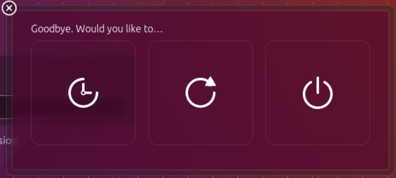

My Windows VMs (Server 2016 & 10), RHEL 7 & Ubuntu Server 16 LTS all shutdown without issue, but the Ubuntu 16 LTS desktop install gets stuck since it's asking for user input (see attached screenshot). That may just be a config setting within the vanilla install, but I haven't looked into it much.
index.php?action=dlattach;topic=31735.0;attach=37282;image
Thanks again!
