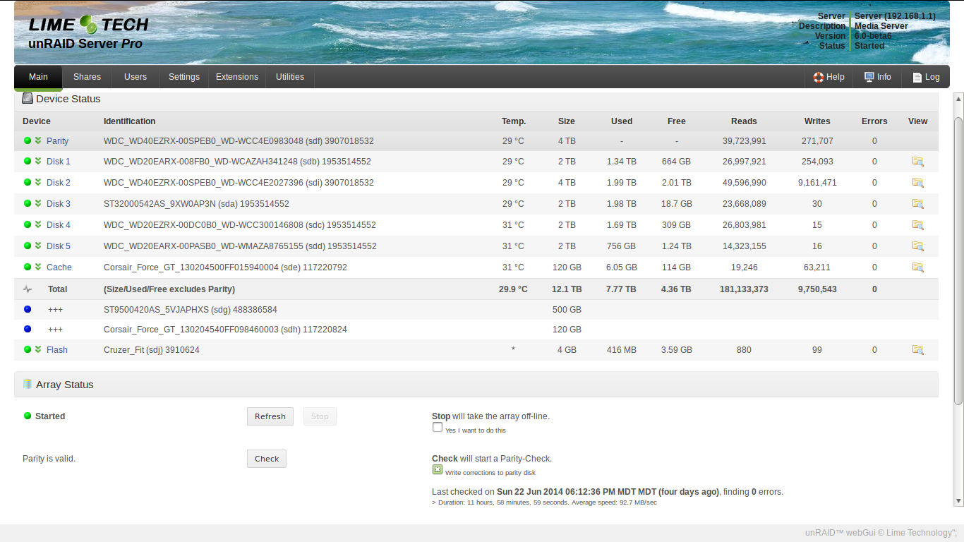

Those drive temps seem fairly high to me.  I'm used to seeing temps in the mid 30's and anything above mid 40's worry me.
I don't think the backplanes fail from inserting the drives.  It seems to me that most backplanes, in general, fail because the pcb traces weren't designed to handle the current load of the drives.  Designers often fail to consider the current of drives during startup.
For anyone into modding cases, I wonder how difficult it would be to cut out the right side panel so that the air flows right through the case from one side to the other.  I highly suspect that is the reason for the high temps.  It is difficult to calculate the exact path of the air flow, but I'm suspecting the current design creates small pockets of stagnant air which prevents proper cooling of the drives.  If anything, someone should try to measure temps with the right side panel partially open to see if it makes a significant difference.
I edited my previous post. Should have been 30C at idle
That's great to know. I think I'll be getting this case then.  Thanks for the feedback!
