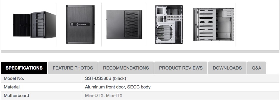

I misspoke in my earlier comment -- not sure if I misread it, or if there was an error on Silverstone's site that's now been corrected => but in any event, the DS380 is compatible with mini-DTX boards (NOT DTX boards).
The mini-DTX form factor is 8" x 6.7"
The motherboard you'd like to use is 8.4" x 6.7" ... so without the case in hand, it's impossible to know whether or not it would fit.    Perhaps someone with the case could see just how much extra clearance there is beyond their (presumably) mini-ITX motherboard.
I'd certainly THINK it will work .. but 0.4" is indeed 0.4" => and if that's too much, it's too much !!
Thanks to both of you. I was trying to capture all information that is available. I don't want to further hijacking this thread and have opened another one:

@Gary, the Silverstone site is still talking about Mini-DTX and Mini-ITX. Please see picture below.
