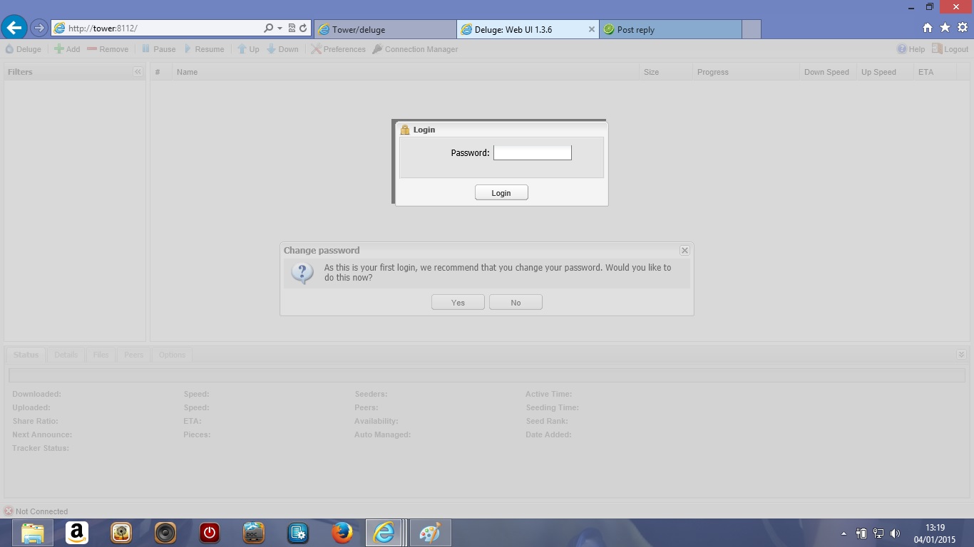

January 4, 201511 yr Got everything up. But the password deluge is not logging in. It keep rebooting back asking password. Any chance of overcome this.
January 4, 201511 yr Author Got everything up. But the password deluge is not logging in. It keep rebooting back asking password. Any chance of overcome this. You can try deleting the web.conf file in your appdata directory. You need to stop deluge first. Also it will reset all your webui settings. There is also a python script. Look here http://dev.deluge-torrent.org/wiki/Faq#HowcanIresetthepassword
