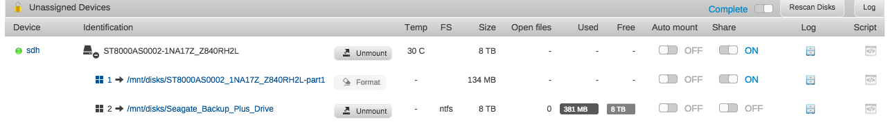

Hi jonathanm,
Thanks for the reply, unfortunately it will far exceed my largest drive (5TB's) so it must become Parity not Data.
I've attached a copy of the Unassigned Drive details (pic) and it probably has an HPA included since 134 MB have been "used".  It is currently formatted as NTFS which I will change to XFS before use.  I've read through the Thread, but confess having some difficulty in knowing how to tell the actual size and/or how to delete the HPA if it exists.
Dave
That 134MB appears to be a 2nd partition, NOT an HPA (which wouldn't show up on the display)
If you attach this drive to a PC, and go to Disk Management, you should be able to simply delete both of the existing partitions ... then have another look and see what it shows.
Run a /dev/sdX  (where X is the assigned letter for that drive) to see exactly what the sector count it.  Then you'll know if there's an HPA or not.

Hi garycase/C3,
Thanks, just ran your hdparm command and got the following (pic).  I can easily attach the drive to my Mac & connect to Windows via Parallels to clear the partition.
There was an interesting article by Mr. Antman (England) checking a Seagate Archive drive in a Drobo which failed d/t the SMS type file structure being used.  In summary the Write Head is larger than the Read Head, thus multiple writes to the HD means the data must be read (d/t size) then re-written.  Not sure how that might affect Parity ????  Interestingly he also tore apart a WD My Book 8TB and found a HGST mfg drive enclosed, but no details as to which series (desktop, green, purple, blue ...).
Let me know if my drive would be ok for Parity and your thoughs about its SMS file structure if you have the time.

Hi garycase/C3,
Many Thanks for the replies!
Dave
That's the right sector count for an 8TB drive, so you're good to go.  In fact, you don't even need to bother removing the old partitions => UnRAID will re-initialize the drive anyway.
