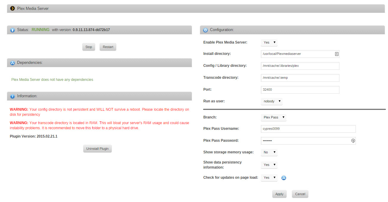

Oops, I was able to get plex working. I just wasn't going to the right address.
However, it's still giving me an error that my config folder isn't persistent and that my transcode location is in ram. I've changed the settings as seen in the picture above. Are those folder settings ok?
I just built a new Unraid 6 box and I'm trying to setup plex. I can't seem to get it to hook up to my plex pass account.
I just use whatever the default branch is and then login within the app.
While what you've created should be fine, the recommended method is to create a cache-only share for holding your application data.  You would then point those folders to that share.  An example might be /mnt/user/appdata/plex/libraries and /mnt/user/appdata/plex/transcode if you created a cache-only share called "appdata"

-               451M  450M  1.2M 100% /
so, /tmp is full. what can we do about it?
Add more memory.  The beta loads have all of the new code for 64bit version linux, Docker and the two hyper-visors.  It needs more memory.  That is part of the reason LT was saying when it hits final they would ofter a build without the extra hyper-visors.
From the hardware recommendation for application server:
    For business users:  8GB dual-channel ECC RAM
    For home users:  4GB dual-channel RAM
http://lime-technology.com/hardware-recommendations/
Even though the minimum recommendation is 4Gig, I would got to 8Gig if I were you.  This is the reason I put 16 in my server day one even though it could not really use it.
So, as you know, unraid loads its entire OS into a RAM drive, or in other words, a portion of your RAM is used as a fake hard drive where the OS gets installed to one each reboot. That portion by default is 50%.
This means the OS, all plugins, all dependencies are always in RAM.  Unraid 5 uses a 32 bit OS where as unraid 6 uses a 64bit os. The 64bit OS has much larger footprint. If you start with only 1GB ram, your tmpfs ram drive will only be 500megs which is really small for an entire 64bit OS and extra dependencies like python, mono, or java.
Remember that when you see "not enough space on device" that 'device' is actually the tmpfs ram drive. You likely need more ram as the user above stated.

root@UNRAID:~# df -h /tmp
Filesystem      Size  Used Avail Use% Mounted on
More ram. (4gb I recommend minimum)
