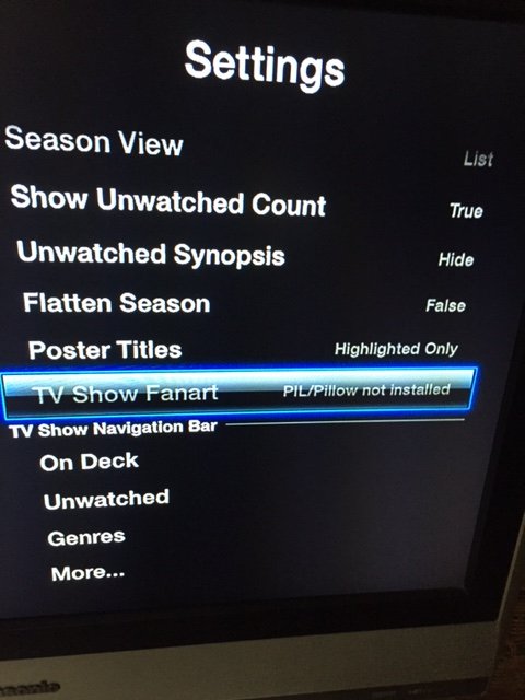

Strange that it says pil is not installed but I have it working on my test machine. Also, change the DNS master (next hop) to your router IP so it bounced there after hitting the unraid server.

OK I just put an update put that fixes PIL which should give you fan art images now. Let me know if that helped.
ATV under TV Shows says it's not installed.  I rebooted the ATV also
yup
Oh PIL. Did you update to the latest plugin also? I sent an update after midnight last night.
Might need a reboot after the update also. It ended up being a bunch of missing dependencies and a broken dependency which are all included/fixed now.
yeah, I updated the plugin but did NOT reboot.  I will try that later.  Need to go to work  :'(
OK, the package I fixed is named the same as the broken one so the reboot should reinstall it. Let me know tonight if you get the chance.
