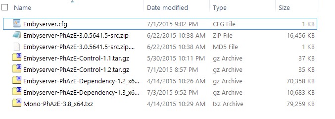

PhAzE, here is a tough one.
The following occurred before your latest Emby update.
Since I updated to unraid ver 6.0, I loose connection to the emby server every time I turn off/on my computer.  The error code, "Failed to detect version," appears. I update and go through setting in the server, but this only holds for the current session.I have to repeat this process every time I fire upmy computer.
Update: I held back on letting you know of this situation until you released the updates for the current unRaid version, thinking a new update may solve the problem. Well, things only got worse after the update.  I discovered the entire Emby installation (installation, config, and metadata files) was moved from the cache share to the disk 3 share. I have no idea how this happened. So now, I have a blank cache drive
I copied all the files back to the cache drive and tried to reinstall your plugin on top of this. Trying to update the plugin gives me this:
"plugin: installing: https://raw.githubusercontent.com/PhAzE-Variance/unRAID/master/Plugins/Embyserver.plg
plugin: downloading https://raw.githubusercontent.com/PhAzE-Variance/unRAID/master/Plugins/Embyserver.plg
plugin: downloading: https://raw.githubusercontent.com/PhAzE-Variance/unRAID/master/Plugins/Embyserver.plg ... done
Cleaning up previous install files...
Found correct version of plugin control files. Ignoring
Found correct version of Mono dependency file. Ignoring
...Cleanup complete!
Downloading any missing plugin files...
Latest plugin dependency files downloading
...Downloaded plugin dependency files have failed MD5 check. Deleting and aborting install
plugin: run failed: /bin/bash retval: 1"
What do I need to do to correct this "dependency files have failed MD5 check?"
Thanks,
Oh just run it again. Sometimes the connection to github fails because they are binary files instead of text files. You can also try to set your DNS to 8.8.8.8 and install it, then set it back to your original setting as I've seen DNS issues with github also.
Basically that error just means it failed to download the dependency file and you had no copy on your USB drive.
As for it moving the files, that's very strange, I've never seen that and no code I can think of would do that.
Try using /mnt/cache/yourfolder instead of a s cache only share with /mnt/user/yourfolder. I find it always works when using the direct to cache path.
That might have happened with the unRaid upgrade. After I did the upgrade, I kept getting a " Failed to detect version" error.  In retrospect that was probably  telling me the server files could not be found.
I'm not connecting to github by either method you suggested. I will keep trying. However, I'm looking at what is on the usb stick and it seems all I need is stored there in the plugin directory. Are there instructions as to how to do this manually?
Attached is a picture of the files found
Thanks, again
