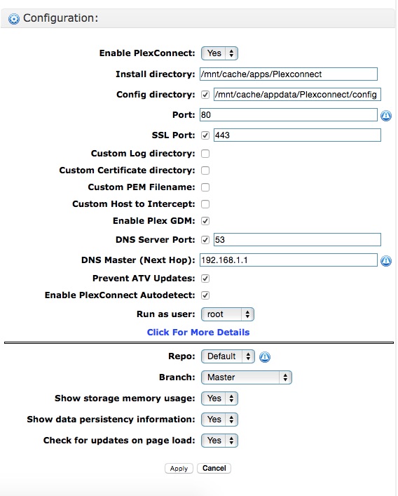

I can't get Plex Connect to work since upgrading to the newest version.  Any idea?  Settings are attached and my ATV is set to 192.168.1.60/trailers.cer
anyone have an idea?
Can you post the log file for the application? It should have details inside, also what build of unraid/are you running again? Did you happen to upgrade to any of the rc's?
