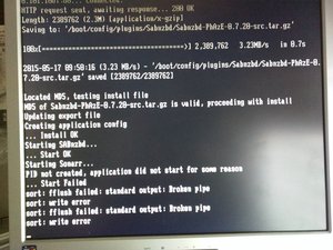

What's up Phaze... I am on 6RC1 fresh install and 2 plugins are acting squirly. Sonarr gives me
 Cannot write: No space left on device tar: UI/vendor.js: Cannot write: No space left on device tar: UI/vendor.map: Cannot write: No space left on device tar: Exiting with failure status due to previous errors Updating export file Updating application config ... Install OK
A whole string of that and SAB wont install either. It was working fine for 8 hours. Came back home and neither were working.

It seems like something else it's up. Do you have other plugins installed that aren't mine? What version is unraid are you running, 5 or 6?

How much ram is in your nas? Also how many plugins are you running?
8GB ECC ram
2 total and both your plugins running SAB and Sonarr. To further assist. here is syslog and img of screen output. I posted on a thread in general support and they suggested it was sonarr and to let you know.
Status: RUNNING with version: 2.0.0.3004 <- sonarr

Interesting, I haven't tested RC1 yet but the error it shows is "not a valid assembly" which means it's trying to run the wrong arch type version. I'll see if I can look at that tomorrow as it may affect other plugins if it involves a core change at the os level.
