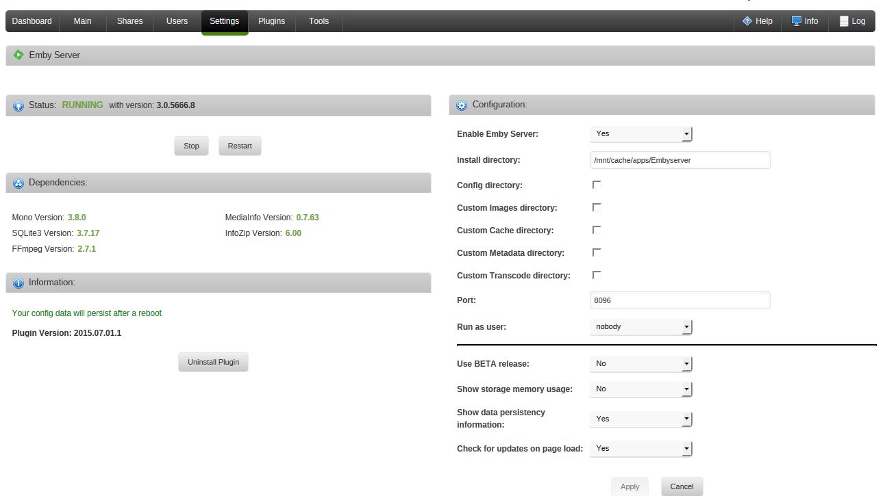

seems installed OK- see attached for pic of plugin page
Turn off all the custom folders, and set the config folder to your /mnt/cache drive, then try it. All those folders go under the config folder by default anyways.

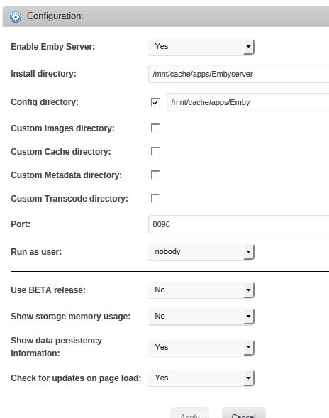

Unchecked the custom folders.
pointed config folder toward /mnt/cache/apps..
odd thing is after a restart the config folder option is unchecked again and blank?  the option does not seem to save(see attached screenshot).
http://tower:8096/mediabrowser/web/wizardstart.html  still comes up as a blank page
thanks,
Can't be the same folder add the install folder so it changes to/mnt/cache/apps/emby/config which is fine. Working now?
Try using your IP instead on the DNS name. Click running and on the blank page change tower (or whatever you named your server) to the IP address.

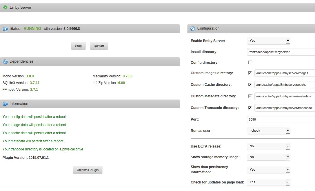

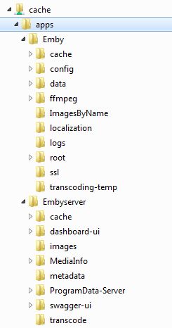

OK the changing config folder to something different worked in regards to at least the setting is now saved.  See attached screenshot(s) for plugin configuration and the folders it created.
still can't access the page....tried the IP also:

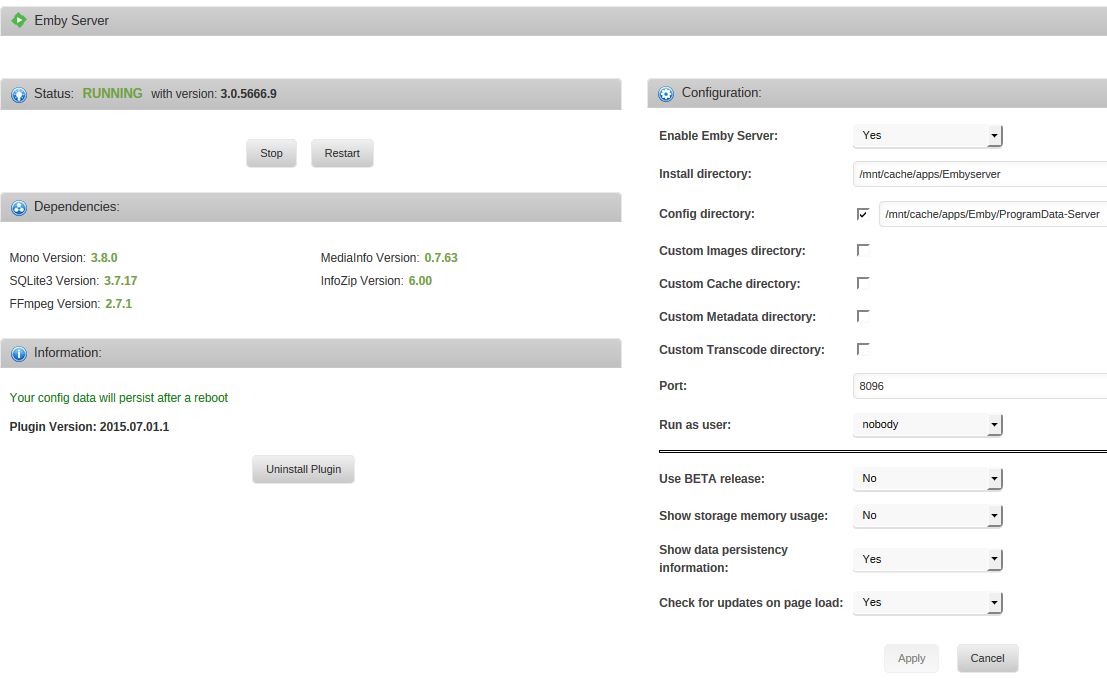

This is what i was talking about when i said the new update isn't working.
