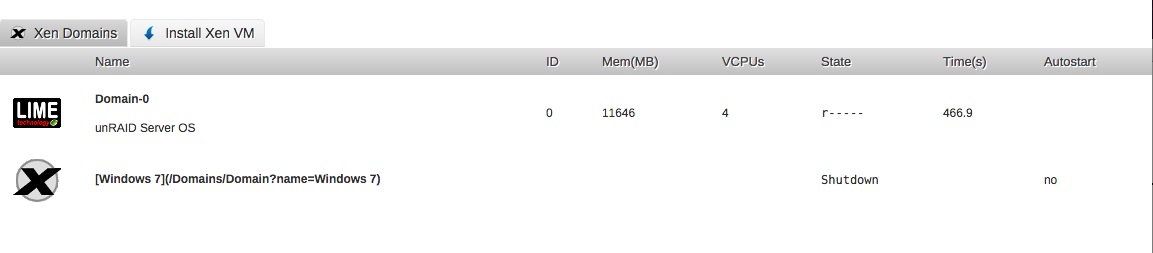

Any clue why I'm getting this in the Xen tab?  Everything works great, outside of control within the WebGUI.
Been at this since early this AM. Using v6b12.  I look at the webGui looks like I should be able to show path to Win7 except in my lack of knowledge don't know where that path would be on unRaid 6.  Maybe mnt/cache/VMs/Windows7/Win7x64.iso?? That's not what I've done so far, just a guess…
