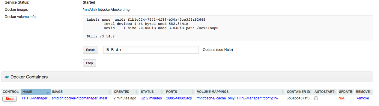

Is this OK?
All seems to be working great, just re-downloading images now. Thanks!
I wasn't 100% sure of the update order but i did the following.
Deleted docker plg from plugins.
Updated unraid to beta8 & reboot
Ran btrfs subvolume delete
Started docker and added new img path
Ran  CP for existing template move
Deleted -boot/config/plugins/dockerMan.plg - /Docker-startup.plg  - /dockerMan-2014.08.28.tar.gz
Ran this same process, so far so good. Yet to test anything on it though (plex, etc.). But I was able to re-download images just fine using my previous templates.
Did a reboot with all docker images set to auto start, things came up like they did in beta6.
APC UPS appears to still be working, status is good in the UI (untested though by unplugging power to UPS).
Appreciate the walkthrough! I'll update once I've started using it for watching shows.
