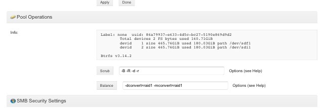

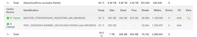

I have two 500gb drives as a btrfs cache pool.  Main page reports
1tb cache drive.  Shouldn't this be 500gb?

It likely depends on what RAID you are running. RAID 0 will stripe the data between the two drives, effectively treating it as one drive the total size of your drives (which looks like what you have). However, there is no redundancy here - just a speed increase.
If you did RAID 1 then it would mirror the data, so you'd have two copies of your data, but would only see 500GB.
I used the default btrfs balance command for Raid1 support.
This is a known quirk about how btrfs reports free space and has proven to be an endless source of confusion.  A little googling will give you all the gory details
