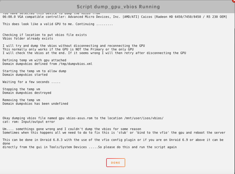

  21. Got the following error: cat: rom: Input/output eror Did powerdown the server stopped docker and had all VM's set to not autostart. The Tools/System Devices does have the Video and Audio checked. GPU is not primary.
