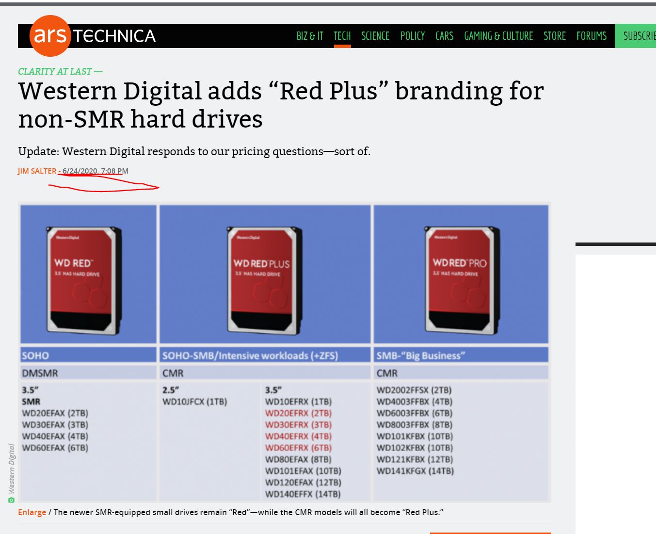

Quoting ArsTechina article at this link
https://arstechnica.com/gadgets/2020/06/western-digital-adds-red-plus-branding-for-non-smr-hard-drives/#:~:text=The use of SMR technology,their existing WD Red branding.
"The company is taking a new branding initiative to clarify the technology used in its NAS drives—in the near future, "WD Red" will exclusively mean disks using Shingled Magnetic Recording technology, and "WD Red Plus" will mean disks using Conventional Magnetic Recording."
"From Red to Red Plus
The use of SMR technology in Western Digital Red is not going away—but moving forward, "Red" will exclusively mean SMR disks. The existing SMR models—WD 20/30/40/60 EFAX—will retain their existing model numbers and will retain their existing WD Red branding. Meanwhile, the CMR disks formerly known as WD Red—in sizes from 1TB to 14TB—get a new "WD Red Plus" branding and label, although their model numbers also remain the same."

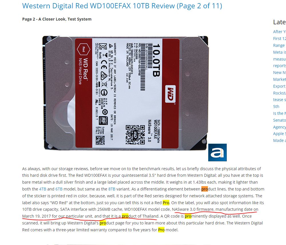

I have no problem agreeing that generally, new RED drives being offered now are SMR, that was not the original question, at least not as I understood it, I though you were asking about RED drives in general, and to your point, took me two minutes to find a couple of examples of new CMR RED drives still being offered for sale: 6TB, 8TB and 10TB
And if you did your homework  you would find the Amazon WD 10 TB is from 2017. Hardly a new model. I would never purchase a 2017 Ford Mustang or 2017 Toyota Camry as a new 2023 car, regardless of the mileage.
Screen capture is from this link   -   https://aphnetworks.com/reviews/western-digital-red-wd100efax-10tb/2
Not sure why are so adamant suggesting WD is still manufacturing WD drives as CMR! This is simply NOT true.
