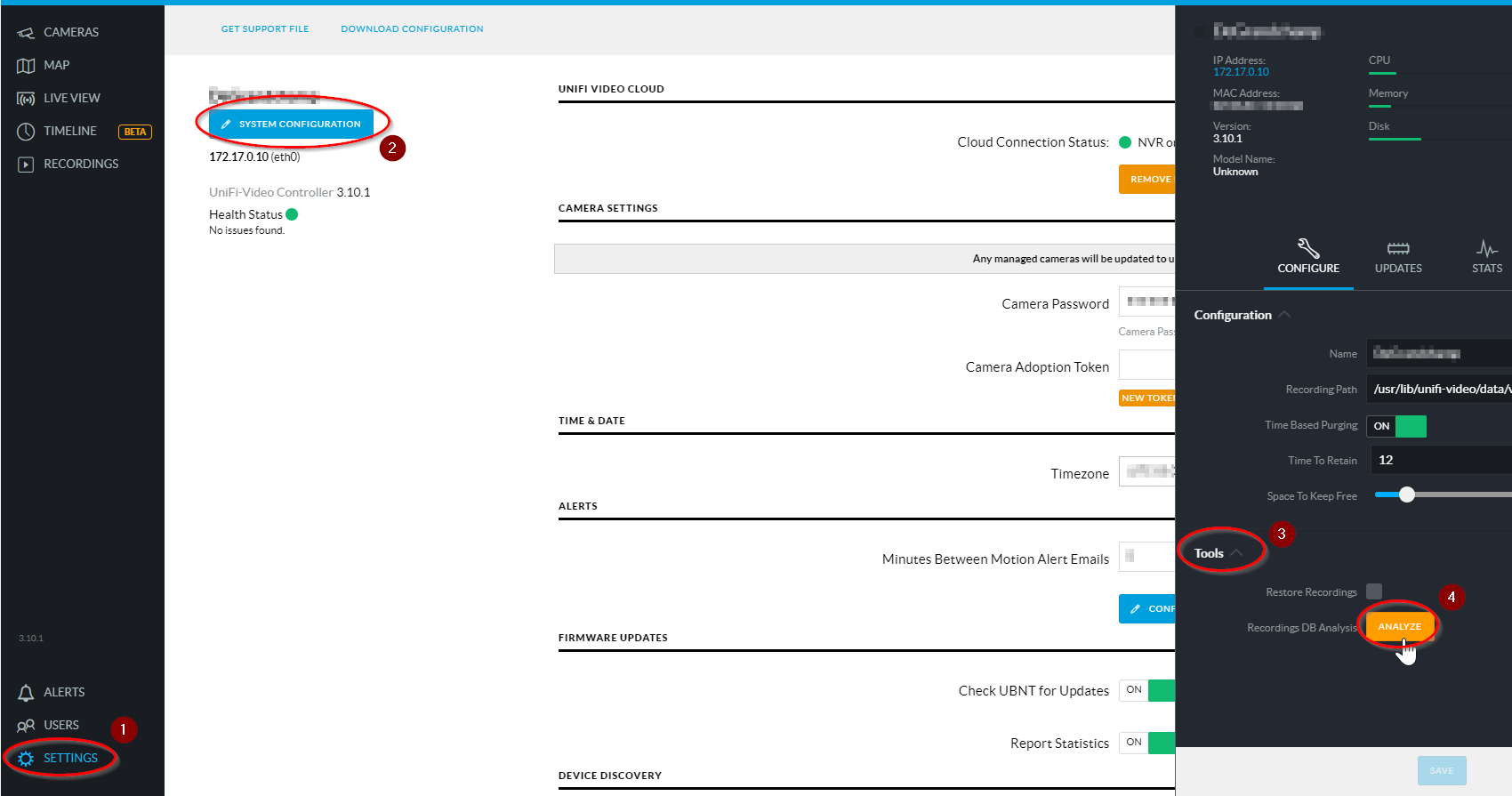

Confirming that this worked for me as well.  After deleting and reinstalling the docker, it took a while to apply permissions to my recordings, and then the old recordings don't show in the new console, but i'm back online again at least.  I'll look around to see if I can get the old recordings to appear again, but I'm guessing that they can just be deleted from storage.

Someone else above told me how to do this, so they should get credit, not me! But... as long as you pointed your recording directory to the same as before, you just need to scan for them. -- I was able to get all my recordings back this way!
Worked for me too, but I made sure to check off "Restore Recordings" first.  When I clicked "Analyze" without it checked, it warned me that it may delete missing recordings it finds.
Further to this, after restoring the backup and restoring my old recordings, I noticed that the version number in settings was still 3.9.x, but in the main web portal it was 3.10.1.  After restarting the docker, I got the dreaded "Updating Unifi-Video" page again and my heart sank...luckily it sped through the different steps and I was running again in less than a minute with both pages showing 3.10.1.

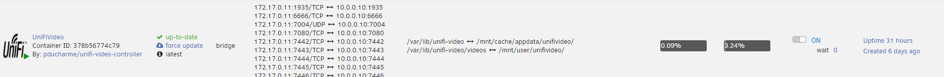

I'm just showing the RAM constantly creeping up towards 4GB in Advanced Docker settings.  Then I keep seeing this in my syslog:

This is all i see when I show advanced docker view, it doesn't tell me how much it's using up though.
I don't have a hard limit set on any containers that i know of, so I'm not sure how I can see how much it's actually using?
I don't seem to be running into any issues on 3.10 though yet after I did a fresh install of it.
I see this.  Might be new view features in 6.7RC.
