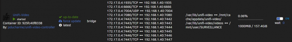

Just wondering if anyone noticed anything wrong with my setup? I had a power outage and on restart it couldn't find system.properties so I eneded up reinstalling from backup.

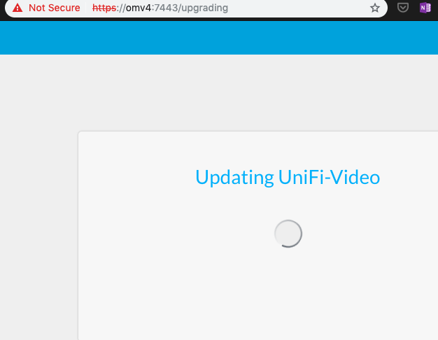

So I had the docker working on 3.10.1 then it started going to the Upgrading Unifi-Video screen and seems to be stuck there.  I have deleted the docker completely and when I reinstall it, it does the same thing.  How do you fix this issue?
root@localhost:# /usr/local/emhttp/plugins/dynamix.docker.manager/scripts/docker run -d --name='UniFi-Video' --net='host' --privileged=true -e TZ="America/New_York" -e HOST_OS="Unraid" -e 'TCP_PORT_1935'='1935' -e 'TCP_PORT_6666'='6666' -e 'UDP_PORT_7004'='7004' -e 'TCP_PORT_7080'='7080' -e 'TCP_PORT_7442'='7442' -e 'TCP_PORT_7443'='7443' -e 'TCP_PORT_7444'='7444' -e 'TCP_PORT_7445'='7445' -e 'TCP_PORT_7446'='7446' -e 'TCP_PORT_7447'='7447' -v '/mnt/cache/appdata/unifi-video/':'/var/lib/unifi-video':'rw' -v '/mnt/user/UnifiVideoStorage':'/var/lib/unifi-video/videos':'rw' -v '/mnt/user':'/unraid':'rw' 'pducharme/unifi-video-controller'
So I managed to get mongo working but now when I login, it will not take me past the login screen.
UPDATE:  I had to use https://[IP]:7443 to login and get to the management interface.  http://[IP]:7080 will not take you to the management interface.

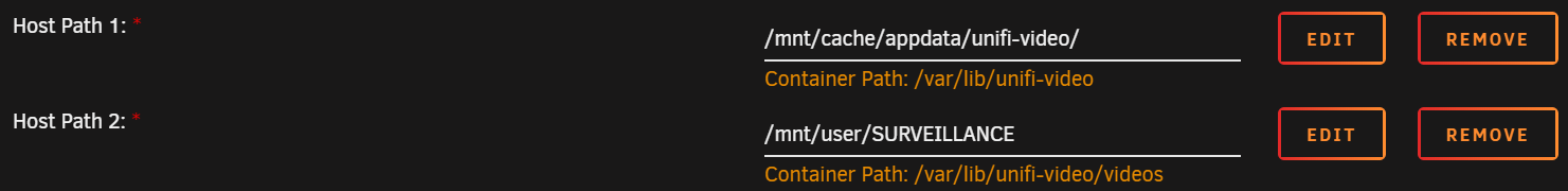

I am unable to record, to the share I have created "/mnt/user/unify-video/video".  I tried to change the recording path in web ui to /mnt/user/unify-video/videos, but it says that the path does not exist.  Any tips would be greatly appreciated
  • 4 weeks later...
Any chance we will see the 3.10.3 update pushed out soon?
I had the same issue. Set your host path to whatever you want but in the UniFi Video system config use the container path as: /var/lib/unifi-video/videos
This is how I have mine configured:
