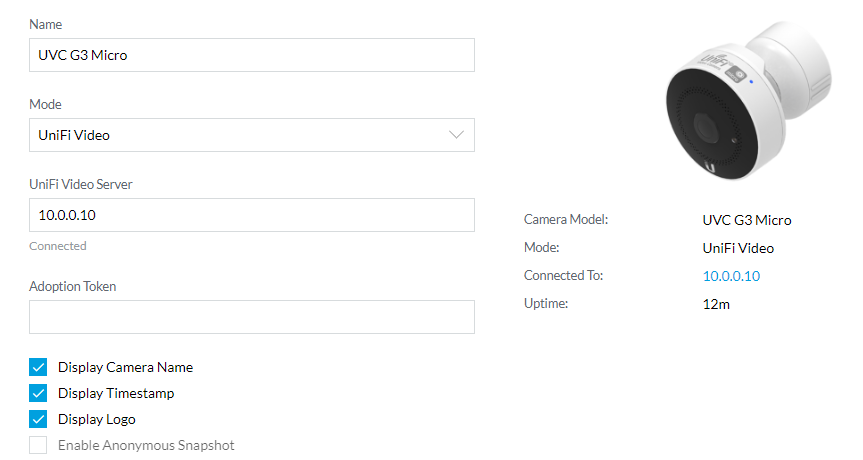

New UniFi Video docker - set to Bridge mode - which I would realllllly like to keep it at, but unfortuantely it's having issues now with adopting a new G3 Micro - this is my first UniFi video cam and it wont adopt into the NVR unless I have the container on its own IP w/ br0 mode set.
This means it cannot talk to my other containers in bridge mode now though because of this, which means I can't use the cameras in the way I was hoping.
Any way to get it working again in bridge mode as it was templated?

I never did figure out what/how the discovery works, I think it must be some sort of multicast thing? You can flop it into host/bridge network mode for the adoption, then afterward flop it out. You can also load up the camera's UI and set the adoption IP / hostname. If you go that route, you'll also need to change that one setting in the controller. It gets populated w/ the 172 address that internal docker uses, but should of course be the hosts real ip.

Ok so I put it in br0 mode, did the adoption and flipped it back to bridge mode, then logged into camera interface and change the IP to my unRAIAD IP address - it's showing up now normally in the unifi video container -- seems ok, but I still see the 172.X address you mention in my container settings but I see no way of changing that - how do I go about changing it?

Looks like a few places have uneditable IPs, now that I go look. But the setting I was thinking of is the per-camera setting for the host controller, as seen at 1XpICgf.png
Ah ok, yep, I've got 10.0.0.10 in mine - my unRAID IP and it's all connected in the controller and accessible via UniFi video cloud account :)
I think I'm good now - time to start tinkering with these more and order a couple more now -- Thanks for the SUPER fast reply on all this, saved me from a night of frustration!
