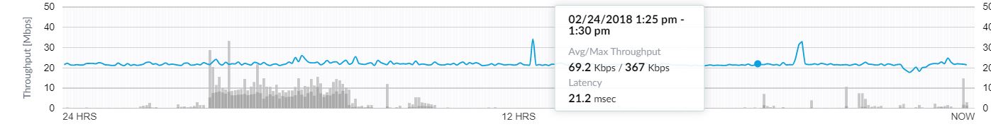

Any idea why the time is incorrect on my Unifi setup?
I checked and unRAID is set to use 0.pool.ntp.org and shows the correct time. Within Unifi, the time zone is set to Central Time (UTC-6). Yet my graphs show that it's currently 8PM when it's actually 2PM. Makes me think the time zone setting is doing nothing at all! How do I fix this?
Edited by spencers

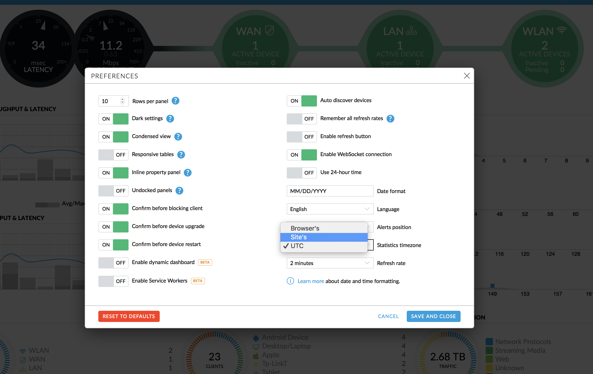

Yeah, check your sites preferences. Click the 3 dots in the top right. Prob set to UTC time.
Wow, that was buried in a place I wouldn't have expected. That solved it! Thank you
