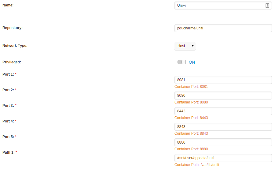

Here is my config for the docker. I put the config in appdata/unifi. Its the same way i do all my dockers. appdata/dockername
@kbb2002, oh sorry you're talking about the unifi docker, not unifi-video. I don't know that one enough to comment on what the problem might be. What you've shown me looks like I'd expect on the surface, so you'll have to dig deeper and/or hope for some unifi help from someone who uses it. :(
