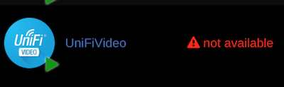

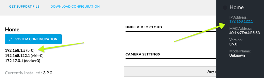

I use the Unifi Video docker and it's running 3.9.0 Beta 6.  Have you restarted the docker?
I have, mine is running 3.8.0b5
Hmm... let @Pducharme chime in as I don't recall doing anything special other than making sure the repository was set to use beta in the advanced properties.
pducharme/unifi-video-controller:beta
I've only recently switched due to a new camera.
Sounds good. Yes I received a G3-Pro and need to use the new updated supported docker for it, 3.9.0b6. I would prefer to use dockers so I dont need to install a linux vm.
Exactly why I switched to the beta controller.
Actually I just found out that the beta Unifi Video has a update option. I figured this would be disabled similar to the controller version. Still need to get an updated beta of the controller.

I've managed to get `pducharme/unifi-video-controller` setup along with my cameras connected to the NVR. However, one thing i'm struggling with is that the controller appears to pick up the wrong IP address:
I have tried with various types of Network Type configured, but can't appear to get it to use the correct one (which should be 192.168.1.5). This means that since the NVR is assigned to my account, i'm unable to connect to it remotely.
Any help would be appreciated, thanks in advance
Ian
Unifi Video 3.9.0 was made available a few weeks ago, so under advanced, I removed the :beta from the docker repository and updated the docker.  Everything seems to be working fine, except it shows as not unavailable in the docker tab.  Any ideas?

I just tried to install this docker and it seems like my WebUI is hung 5a6676ad687a1_ScreenShot2018-01-22at6_40_48PM.thumb.png.c9142191457069624b525d16982ddda7.png
I can still ssh in to the server. I have shfs and kworker both at 100% CPU. The WebUI is not responding at all. How can I recover this?
tower-diagnostics-20180122-1822.zip
