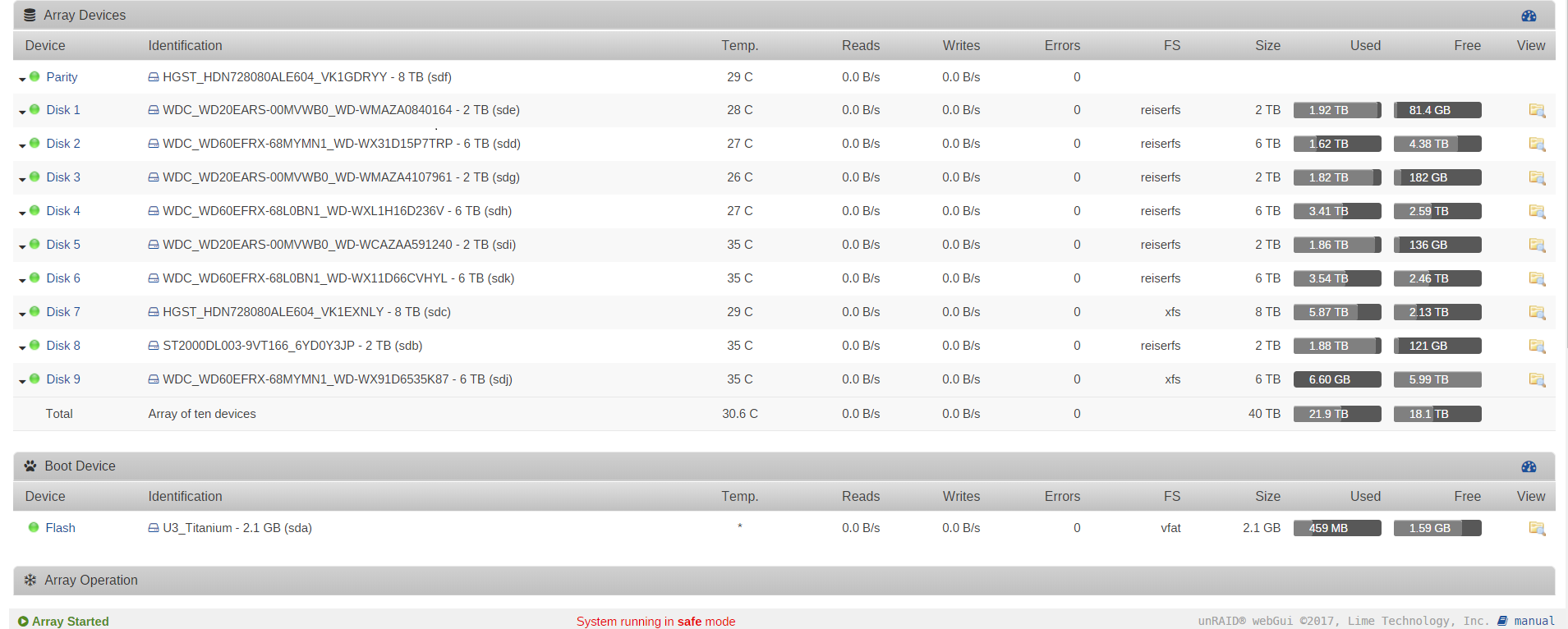

Ok guys this will be my situation as the screenshot follows
And I will be adding another 2TB and then wanting to convert the rest of the driver to XFS including the parity so I can use dual parity further down the line
Can anyone be of any help
Note that the parity doesn't have any file system, so no file system conversion for that drive.
Oh ok so can I expand the size of the parity drive before I do the conversion so I have a larger drive to attach to the array ?

Got a quick question, I'm in the process of migrating to XFS and have successfully transferred and converted one disk already.
My question is after formatting my old ReiserFS drive to XFS I noticed that 6.60GB was used for Disk9 after the format, is that suppose to be normal for a 6TB drive? The only thread I could find regarding this is @
Cheers
Yes, it's normal, about 1TB per GB.
