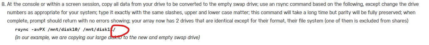

ok I figured out my problem.
I must have messed up my rsync because now I have /mnt/disk21/disk21/ShareName instead of /mnt/disk21/ShareName
probably an errant trailing / or something
That's it exactly.

I followed the procedure in the linked wiki, and after step 16, the data in shares on the formatted drive do not appear in those shares.
I copied disk22(swap) to disk21(old ReiserFS)
now in /mnt/user/ShareName the data which should reside on disk21 does not appear but there is a /mnt/user/disk21 directory no other disk appears under /mnt/user
I seem to recall that this can happen if you miss putting the trailing slash on the command line.   I have circled the one that I am talking about.
The trailing slash is a real hassle to most of us who are not Linux/Unix command line Gurus.  Most of the time, it does not make any difference.  But when it does weird things happen....    (&*$#**  and many other four letter words at this point.)
As a point of information, once you get a set of the command lines used for the conversion of the first disk, use the BASH shell editor to recall each line and then edit it to change the parameters that need to be modified.  It can save making these types of mistakes.  The up, down, right, left arrow keys work as does the <delete> key.   Try it out by working with the following command.  (You can't do any damage with it!)

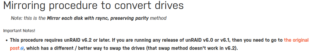

I assume that you are talking about things like this:
Please note that it says v6.2 or later.   This is the procedure that you want to use for 6.11.x (or even 6.10.x).   If you are still running a version before 6.2, then there is a separate thread to be used for those folks.      Version 6.2 was released in March of 2016...
