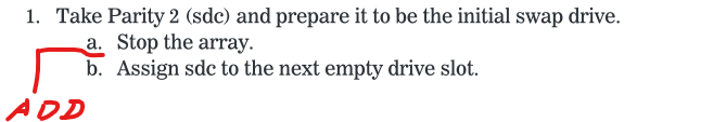

On 5/18/2023 at 11:24 AM, dchamb said:
I am preparing to convert my reiserfs drives to xfs and I've been over the recommended procedure for doing this. If the group could indulge me, I would like to show my procedure, adapted from the one on this forum, to see if I have this down correctly. I have the steps outlined in the attached pdf along with my current array configuration.
I was hoping someone could validate my understand of this process. Does caching need to be turned off before rsyncing files? Does parity get affected by the format of the disk? i.e. when swapping an reiserfs for an xfs, why doesn't this affect parity?
Looking at what you propose to do:
You need to get the array to un-remember  Parity2.   (Otherwise, it will assume that you are going to do a 'parity swap'.)  See here:
https://wiki.unraid.net/Manual/Storage_Management#Removing_parity_disk.28s.29
Looking at the remainder of your PDF, I have a comment.  While you are doing this conversion, don't use the server to anything else!   Shutdown Docker.  Don't be writing stuff to that array.   This will rid you of worrying about files that Mover might be moving onto the array.  This would eliminate the need for Step 4 which will move than double the time required for complete conversion.
I don't think you understand what is involved in steps 11 thru 16 of the procedure.  Make a printout of those instructions and go through it very carefully.  Cross out the example disk numbers and put your own disk numbers in place of them. (I made up a big table/(spreadsheet) for each disk that I converted showing each step for that disk.  As I did each step, I crossed it off.)
One more important thing.  Look at this instruction:
If you use SSH, you must be using 'screen' session.  (Otherwise, if the SSH session is interrupted, what ever the shell is running will terminate instantly!)  I strongly urge to consider using the console.
Yes, because formatting is being done to an drive that has been included as a member of the array.  Every write operation to that drive will cause a corresponding write operation to parity to reflect those bytes which were changed on the data drive.  (Rebuilding a disk rewrites EVERY byte on that disk which includes the File Structure which formatting creates.)
See here for how Parity1 works:
    https://wiki.unraid.net/Manual/Overview#Parity-Protected_Array
Parity2 works in a similiar manner but the calculation of the actual parity byte is done with a matrix operation.
If you eventually decide to remove that 12TB disk from the array when you are done, parity will have to be rebuilt because the removal of all of those bytes on that 12TB disk have to be accounted for in the parity information.
Edited by Frank1940
Thanks for this catch! I will add this to my procedure.
I was really hoping to only keep my Plex docker running during the conversion. Can I disable mover during this time?
Yes I am aware of the drive numbers needing to change for each iteration but I like your idea of listing them out and crossing them off as I go through it.
I will likely use the console. I am not an unRAID/Linux expert so I'm not sure what screen mode is.
The 12TB will need to be removed as I don't have enough slots for another drive and I have a new 22TB to add in to replace the Parity 2 drive.
You've been very helpful. I appreciate it!
